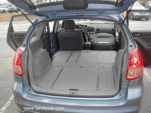

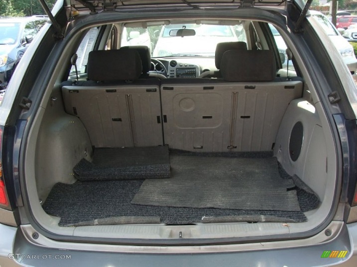

Consider securing the hatch with a cord through the window frame to the roof rack.
I cannot identify any difference between the Matrix hinges and the Vibe hinges when looking at pictures on google.
Matrix:
loadspace Matrix.jpg (40.21 KiB) Viewed 2646 times
Vibe:
Vibe cargo 2 small.jpg (121.67 KiB) Viewed 2646 times

Yea every picture I found showed the parts looking identical. I may just risk it rather than buying the complete liftgate. I appreciate the help! And by the looks of those pictures you're right.
I'll have to see about securing the hatch a bit better. Right now I'm literally only using the car to go to and from work which is only 15 minutes of driving a day. But I still have to be careful.
