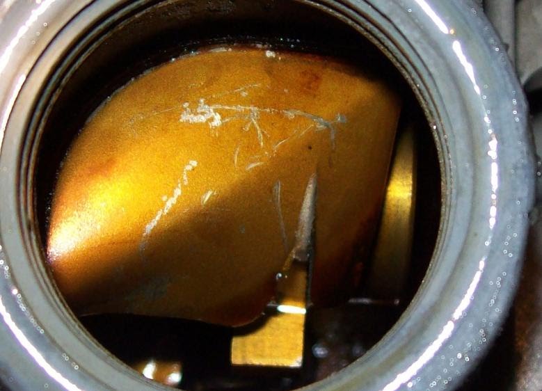

Thank you for the input. I haven't got a chance to look under the oil cap. But I hope the baffle is not as bad as this one I found by googling.

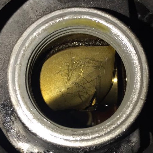

Here is the picture of the baffle in my engine. What should I do now? Thank you.

So I just pulled the bent baffle up.

petervivian wrote:So I just pulled the bent baffle up.
Presumably it solved the problem?

Holy crap. I tore a Toyota dealership a new one for scratching the baffle in our RAV. They have a tendency to just jam that f'n oil pump spigot in there because they cannot secure it properly or are just too damn lazy to hold it. (I generally do my own oil changes, but at the time it was a deal that couldn't be passed up - not to mention the extended drivetrain warranty.)
Who do you generally have do your oil changes? I would be in their faces.
