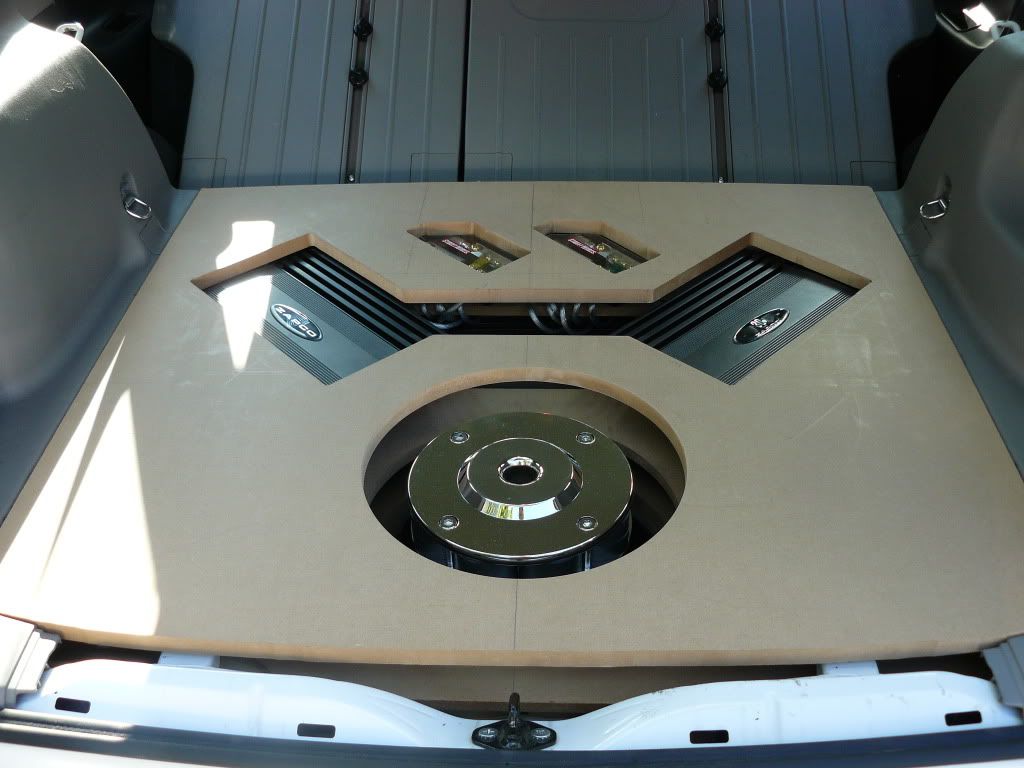

Since Im on the site today. This was version 3 of my Vibe
Here is the build log I made at the time.
viewtopic.php?t=30017" onclick="window.open(this.href);return false;
The only issues I remember was SPACE! Trying to keep everything under the factory floor height was close to impossible. I had to use a Vairovent, and vent the sub to the exterior of the Vibe to get space and performance for the woofer. The only thing I would have changed would be amplification. I would have used less and saved more space for sub placement.
