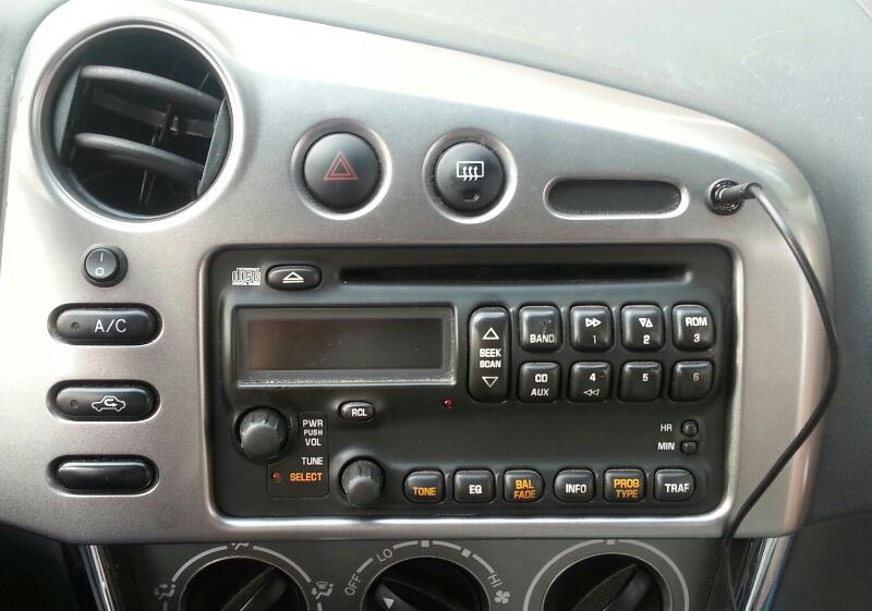

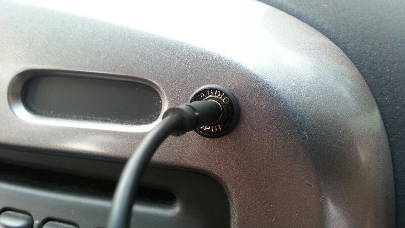

I installed the isimple is31 today to my 2004 vibe factory radio. The isimple is31 is the same as the is32 but without the USB input and indicator light. I got it pretty cheap from here:
http://www.unitedpetsolutions.com/isimp ... adios.html" onclick="window.open(this.href);return false;
It wasn't too difficult to install and it works great! Now I can connect my phone to the car radio and the audio from whatever's playing on my phone plays through the car speakers. Pandora, YouTube, ... anything! You can connect any device that has an audio jack.

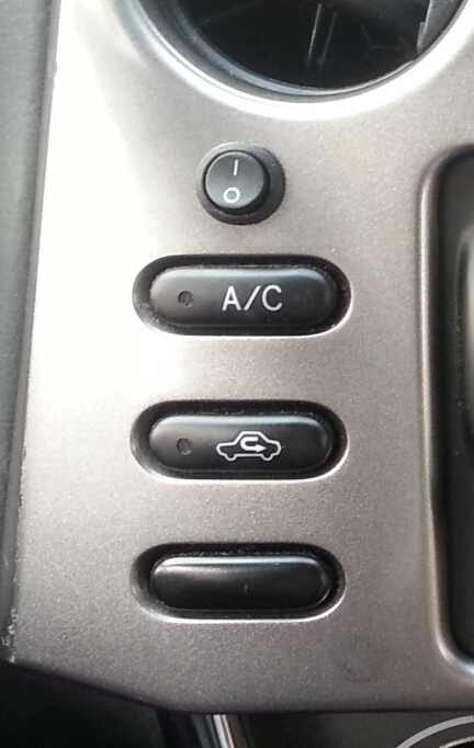

The on/off switch above the A/C button comes with the is31 and turns the modular on or off.
