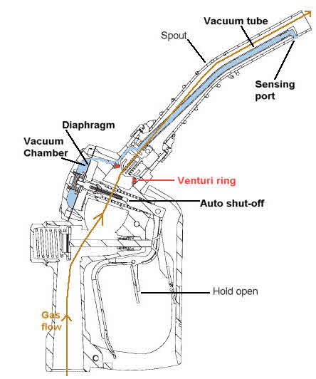

A very detail explanation on how a Fuel Pump Nozzle works. A diaphragm switch enables the nozzle to shut off when the tank is full using negative pressure generated from high velocity gasoline flow inside a narrow orifice .

nozzle
nozzle
4-7-2013 11-17-21 AM.jpg (27.76 KiB) Viewed 4899 times
