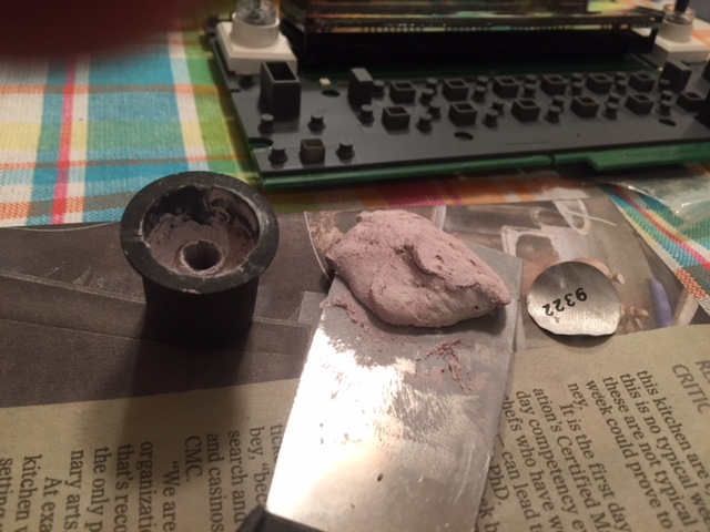

I fixed my radio today. The volume knob has been bad for a while but it recently quit working at all. When I took it apart I found the right knob was cracked so I was glad I purchased two new knobs.
I filled the new knobs with epoxy to the top of the stem. First I stuffed a little cotton in the shaft hole. After pouring the epoxy to the full depth of the stem, I pulled the cotton out. Using any less epoxy would be a waste because it wouldn't be in the right place to work. The knob starts to split/crack at the very end of the stem.
I knew before doing the epoxy that I would have to cut down the clear plastic seen in the picture below where the right knob is missing. The clear part comes up through the white plastic piece. The stem of the knob protrudes into the clear part. I am fairly confident that I won't have to be doing this again.
You can still see light shine through the knob like before. The epoxy may diminish it a small amount but the difference isn't noticeable.

So I took off the knobs, obviously the right knob was damaged, a plastic piece was missing and wouldn't be found. The left one was good prior to disassembling the radio, but the LEFT konb mut have suffered a trauma since a crack was noticable... after putting it back on the shaft, the plastic cracked and a chip of plastic was hanging... still in place, but 2 cracks appeared and the plastic piece was wiggling. I now had to fix this too!
"KRAGLE", show me your power! (Krazy Glue, The Lego Movie reference (KRAzy GLuE)). So I managed to glue the newly cracked left/volume knob. But I knew it would break again, so like another fellow said on the thread, EPOXY is a great thing and saved me many problems in the past. It's a good way to bond and solidify things. BUT, instead of gluing the knobs to the radio metal shafts, I decided to just give the knobs more strength. I coated the exterior of the broken plastic cavity, all around, to create a palstic-like coating that would strengthen this cheap plastic. The metal pre-shaped black metal ring that sits on the metal shaft, I inserted it in the plastic cavity so I'd be sure it would still fit after the fix. I let the epoxy cure overnight. The trick to being able to handle the epoxy well and not have it to drip everywhere, is to mix it (resin and hardener) and wait a little bit for the consistency to become more tacky than runny. If it's too runny (freshly mixed), it will drip down and not stay in place. Most epoxies (in popular hardware stores) are 5 minutes (time it takes for the stuff to become set after being mix). You only have a small window of time to use your mix. So a piece of advice: Mix small batches! Work with small batches, else you will lose your epoxy. Mix a little bit, wait a little for the best handling consistency, and then apply generously all over.
See picture of epoxied knobs:
In the morning, everything was set and hard! The job was a success. I reinstalled the knobs on the radio and everyhing stayed put, no cracks appeared, nothing broke. The knobs were spinning very straight and did their job as new ones would! But they're not new... they're BETTER THAN NEW!
