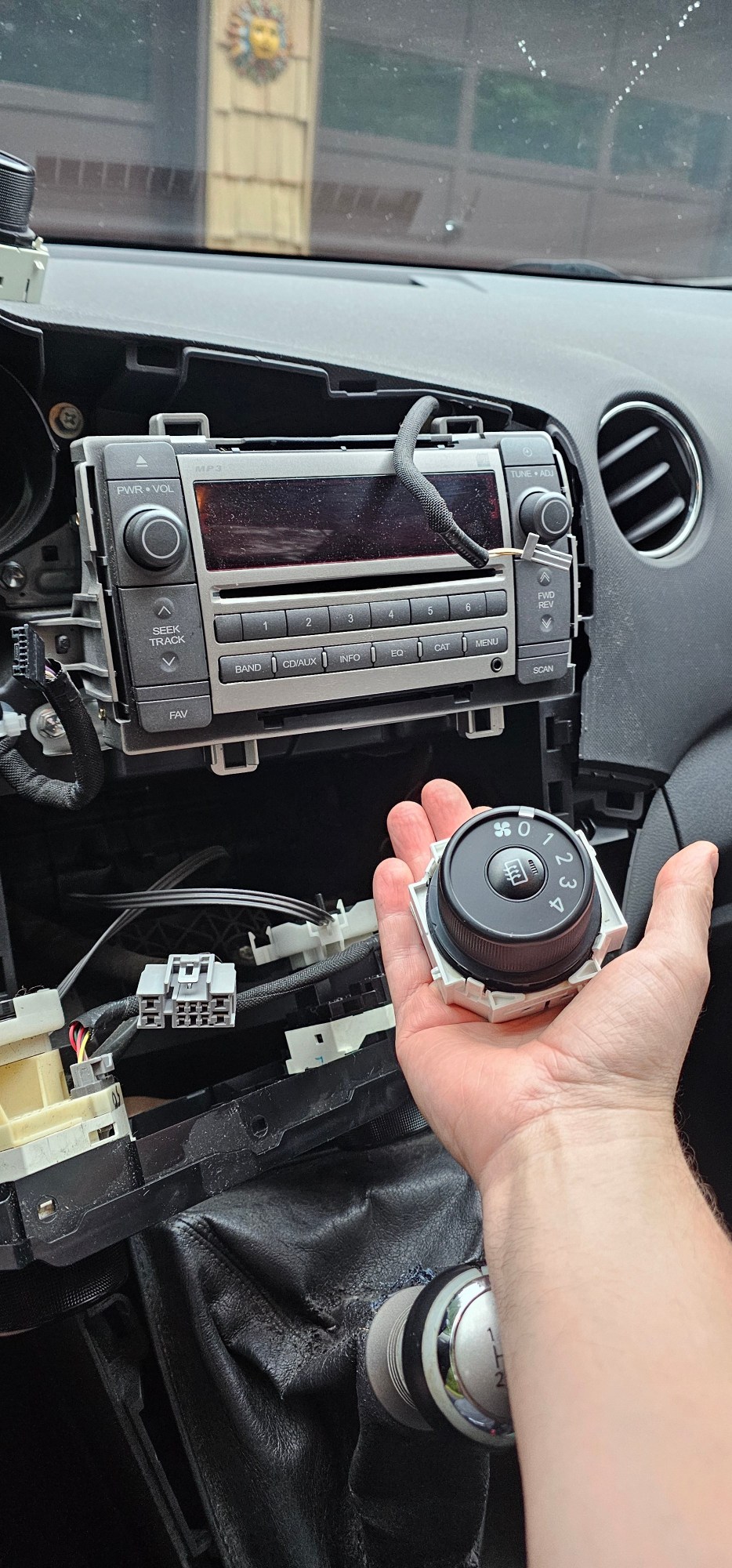

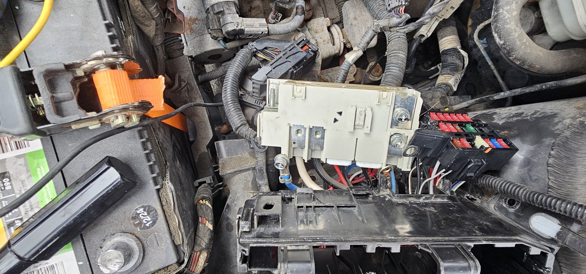

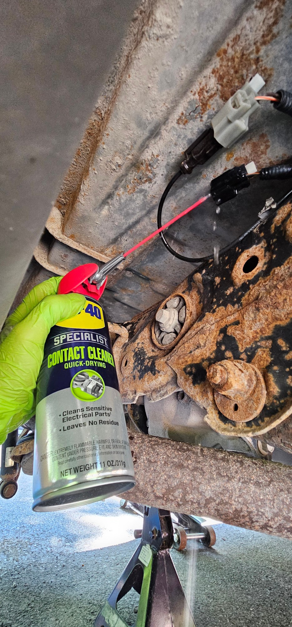

The AC and blower fan stopped working on my vibe.

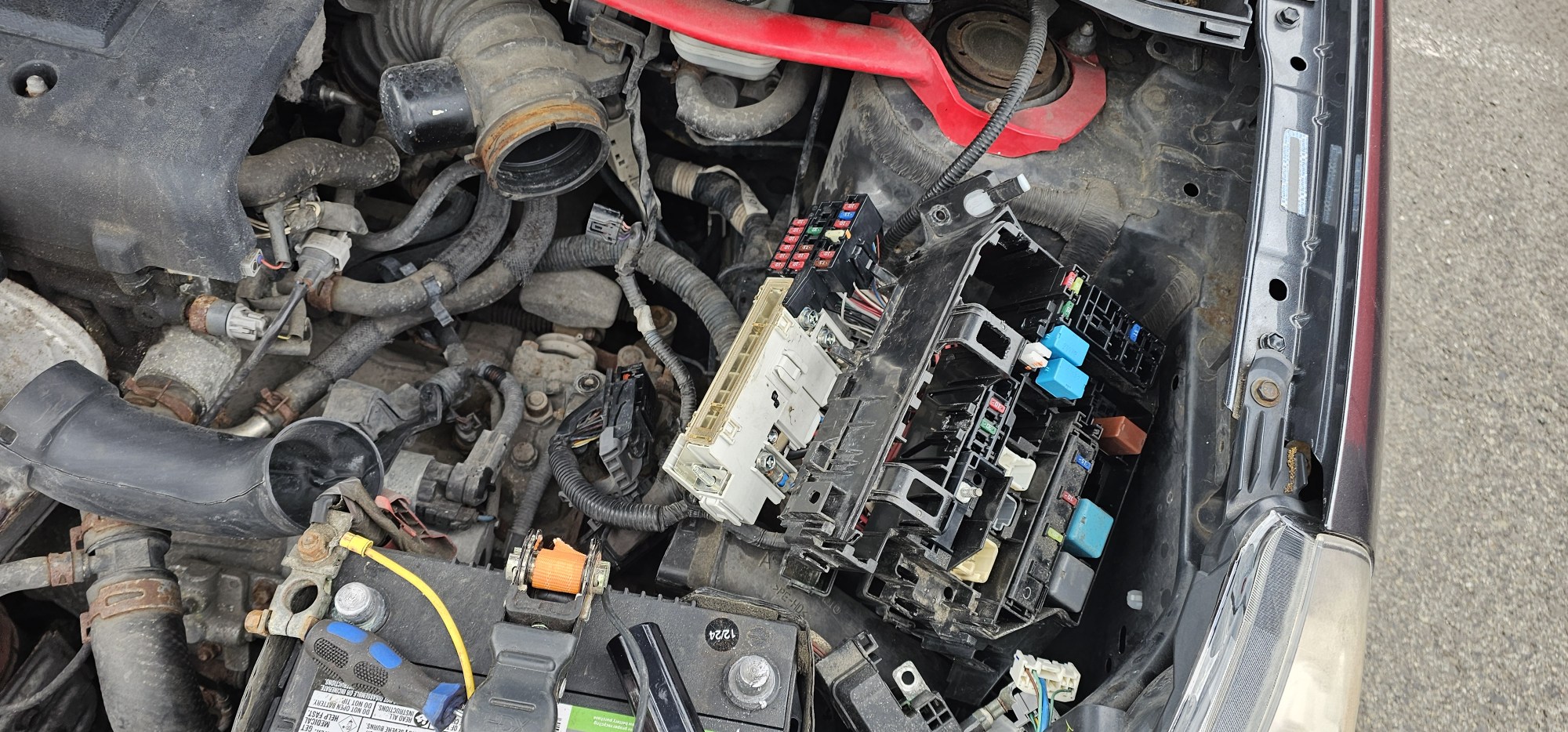

The first thing I thought to try was the fusible link block. This part contains a 50 amp fuse for the hvac circuit. I thought that replacing this may energize the AC controls. this ended up not working. My blower fan controls and AC still wouldn't turn on. To be specific, not only does the blower fan control not work but also the indicator light on the AC control doesn't illuminate when pressed. The two switches appear to not be receiving power. The left most switch is mechanical only. It controls the flaps the redirect air.
20250601_151847 (1).jpg (695.05 KiB) Viewed 36436 times
Whelp. That was a bug waste of time and $35
on the fusible link block wasted..

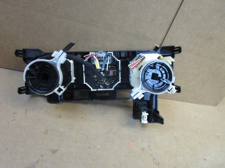

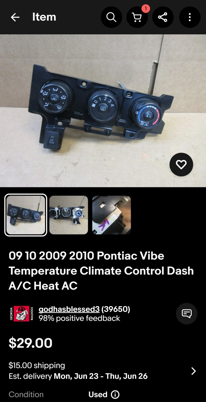

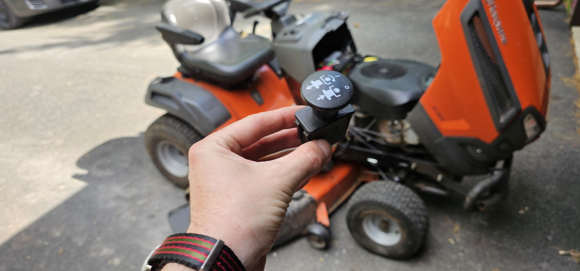

My second try was replacing the blower control switch in the center console. What a peice of cake this one was. This popped into the dash in under 10 minuets.
My AC is now fixed!! Yay! Replacing this single center switch also restored power to the right AC switch.. I was then able to turn on AC.
So the culprit has been found. The AC blower switch was $30 used on ebay. Only the center switch was replaced.
One thing I forgot: its probably a good idea to disconnect the battery when changing this. The light indicator to the passenger airbag scale is connected to the front panel and needs to be unplugged. Since this is connected to the airbag circuit its probably a good idea to disconnect the battery. I forgot this! Luckily my airbags didnt go off.. :shock:
Im glad about this as I just had the AC recharged two years ago.. but that one i didnt diy. It still blows nice cold AC.
I'll need it this summer :D

Re: vibedrivermatt - 2009 Vibe 2.4l
Nice find & fix. I had to "top off" the AC in my 2004 Vibe GT as it was low BUT not low enough to have the low pressure cutout switch prevent the compressor from coming on. I usually have to do this every couple years BUT as the car gets older, I'll likely have to do it sooner. My 2009 Vibe GT is still great! :D Now on my son's 2009 Vibe GT, he has a cable snagging issue of some sort as his ventilation control knob/cable is VERY hard to rotate and get working. Not sure if this is a common problem OR something behind the dash is blocking physical movement of the cable. He doesn't drive it much anymore so we haven't looked into it in detail yet.

Im very glad to have found the fix. I was really taking shots in the dark at it. Had the replacement switch not worked I was about ready to go to a professional.

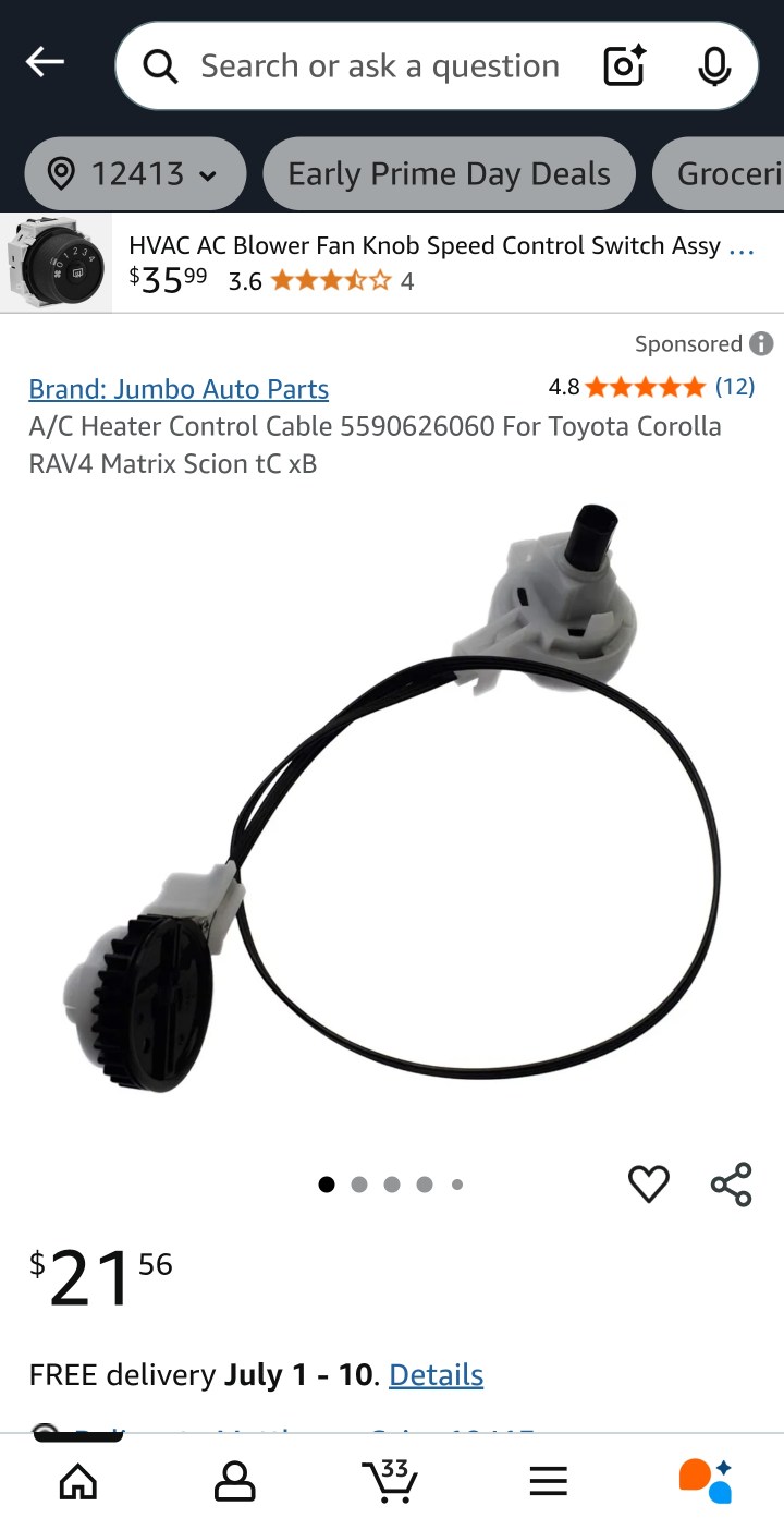

Concerning your sons vibe GT climate control switch. All I can suggest is taking a look at the some of the replacement knobs and cables. Heres some pics for reference.
Screenshot_20250620_062404_Amazon Shopping.jpg (99.6 KiB) Viewed 36399 times
It doesn't look too hard to get that new cable in there based off the lenght. But maybe the cable is fine. Id want to look at the plastic teeth on the gears of the climate control dial and cable to see if any of those were broken off.. there may be different lenght cables for left and right hvac controls dials.
Im basing this off a GM parts list i found on the internet.
Its actually listing two different part numbers for the hvac control cables.

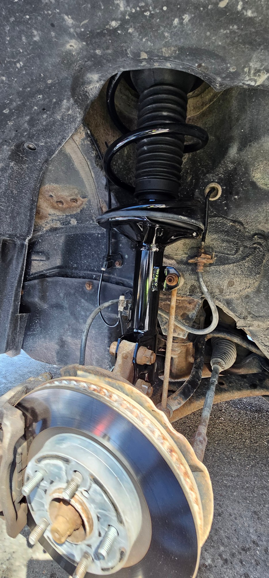

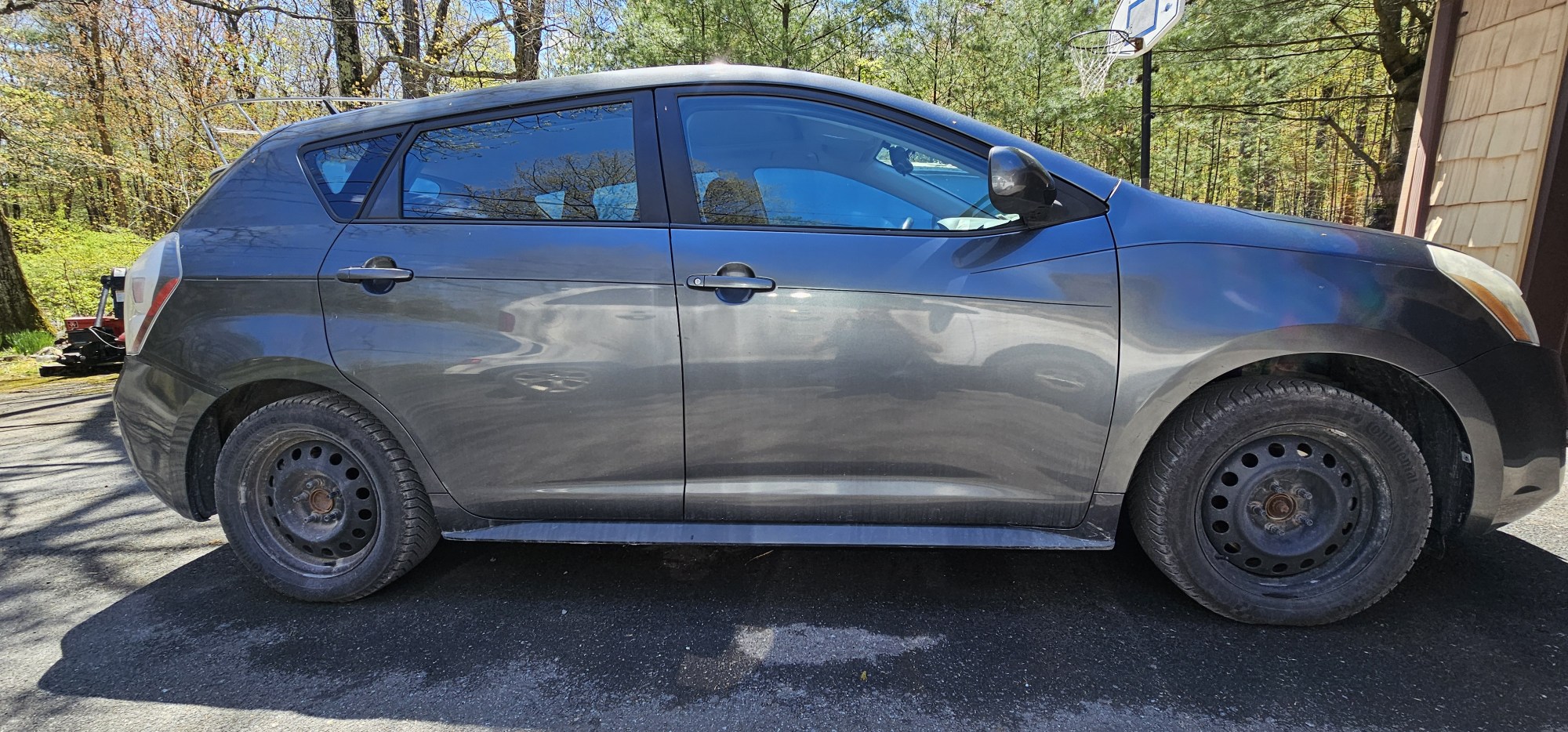

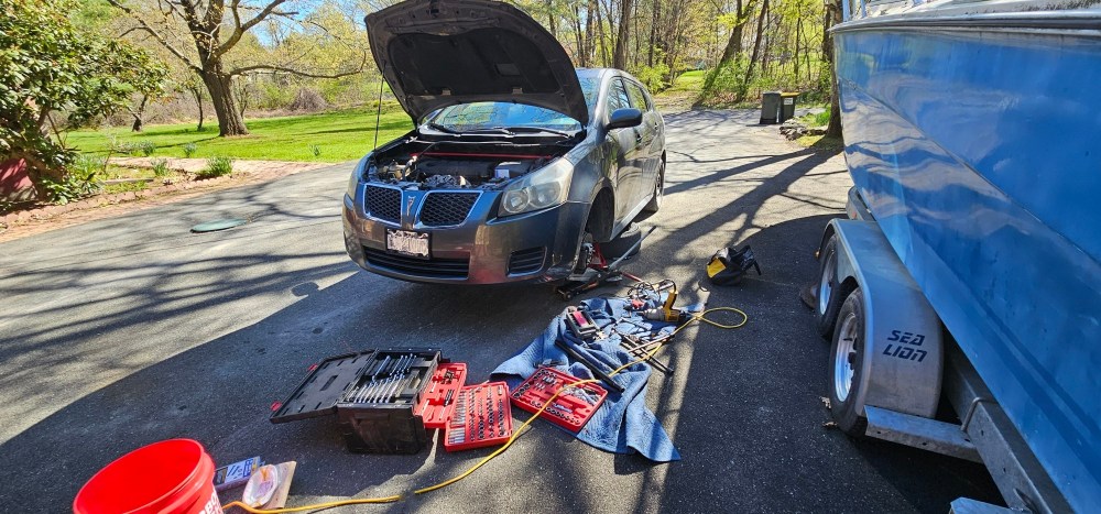

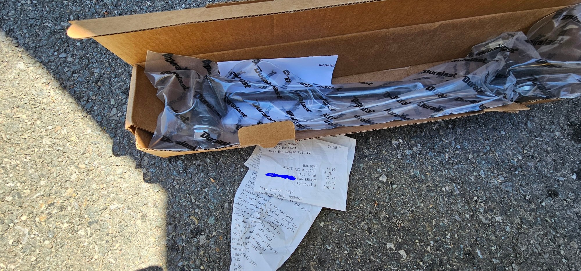

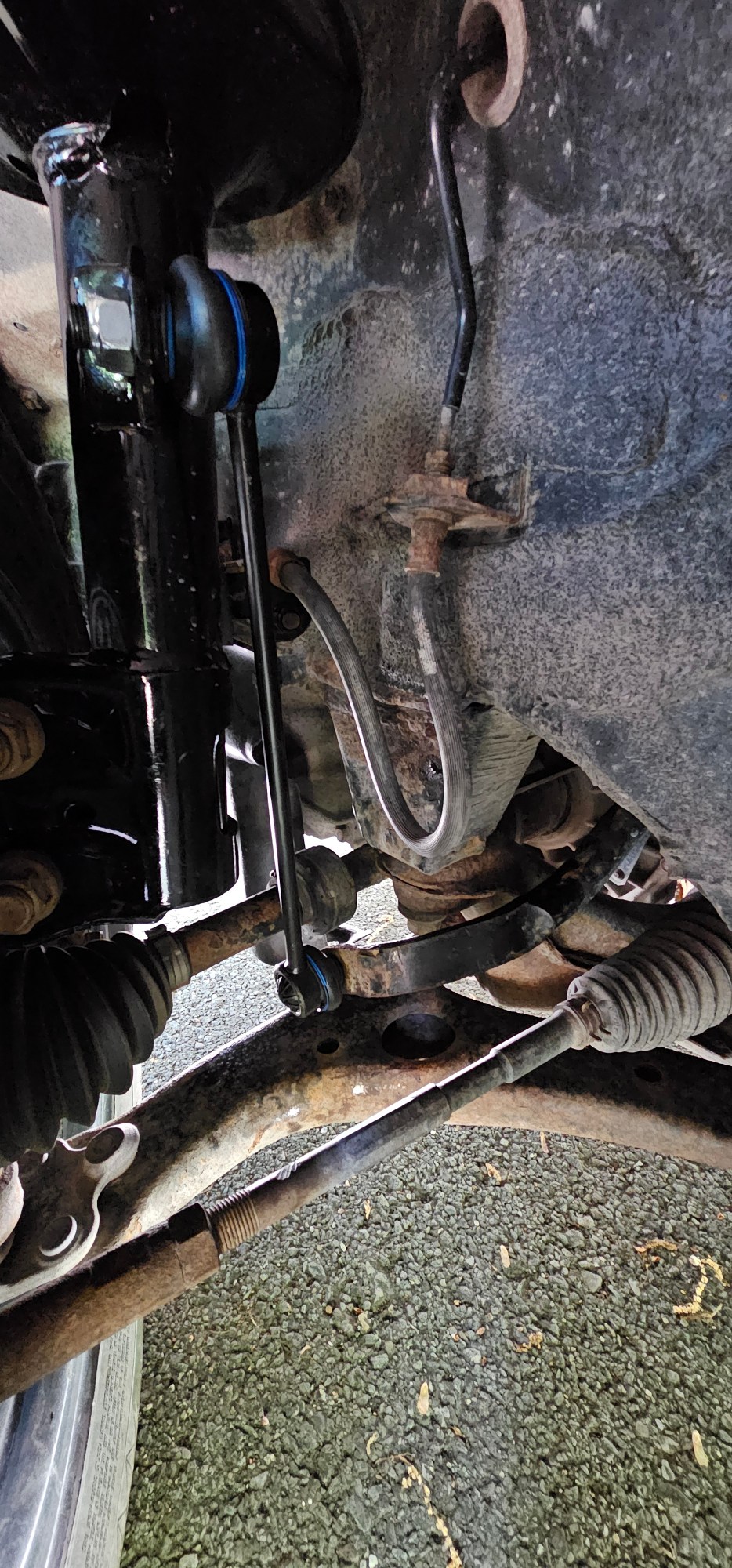

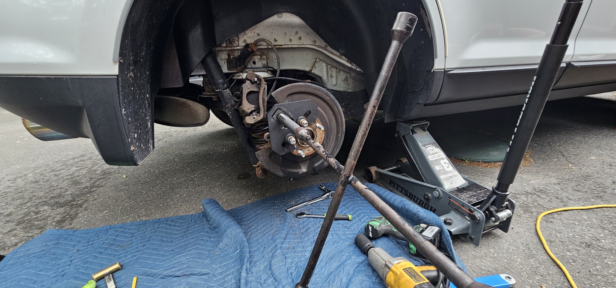

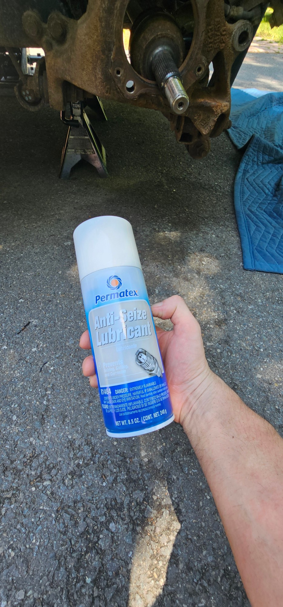

I had to put new struts on the vibe. Honestly, I should have done years ago. The left front strut was beyond gone.
The replacements cost about $160. The replacement parts were nice as they are complete strut assemblies. Its comes assembled with new strut, spring, bumper, bellows and strut mounts. There was no need to mess with spring compressors or take apart strut assemblies. The car has about 135k miles on it.

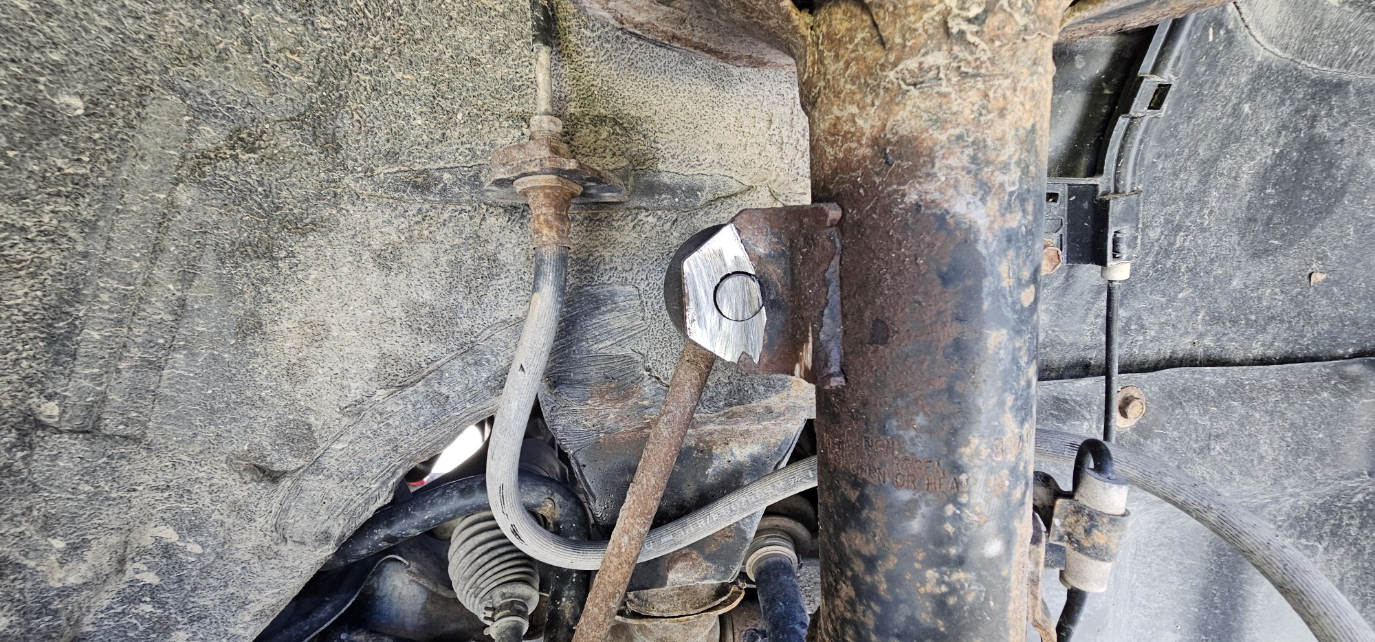

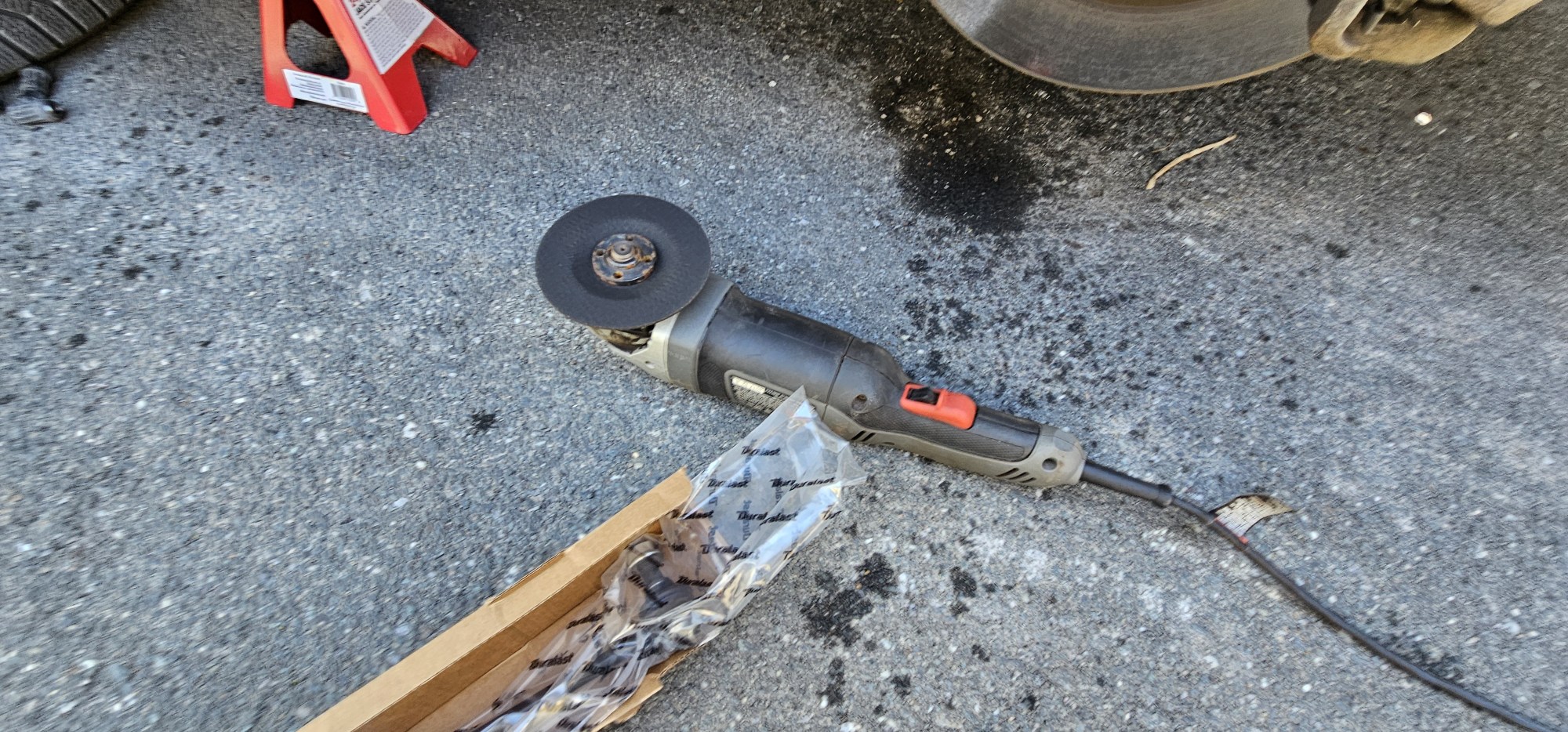

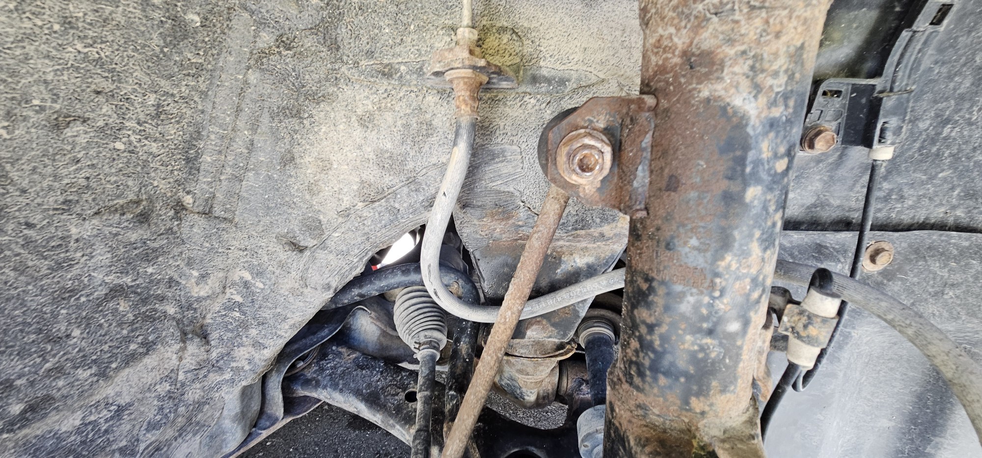

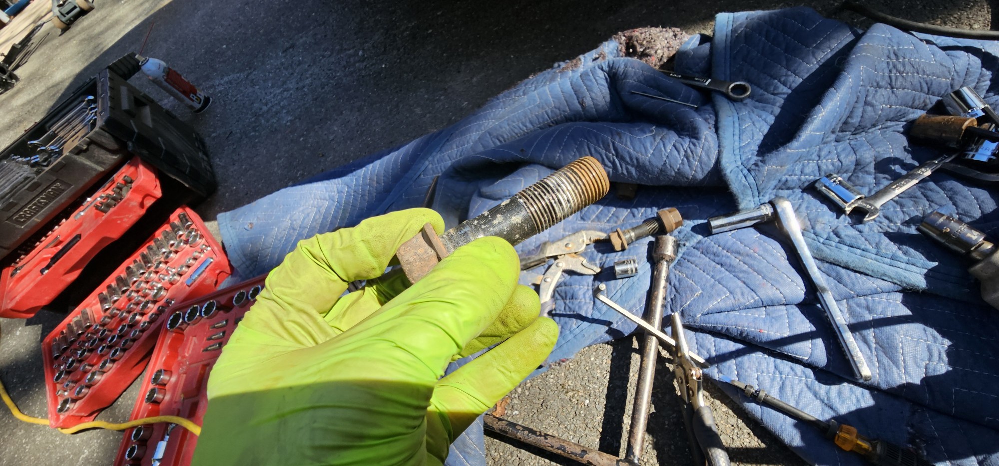

Everything went pretty smooth expect one of my sway bar links couldn't be unbolted. The center hex had rusted out.
Had to cut through it with angle grinder.
I was unhappy to fork over $75 to order a new sway bar link from auto zone.. Those can be ordered a lot cheaper. Oh well. I needed it in a pinch.

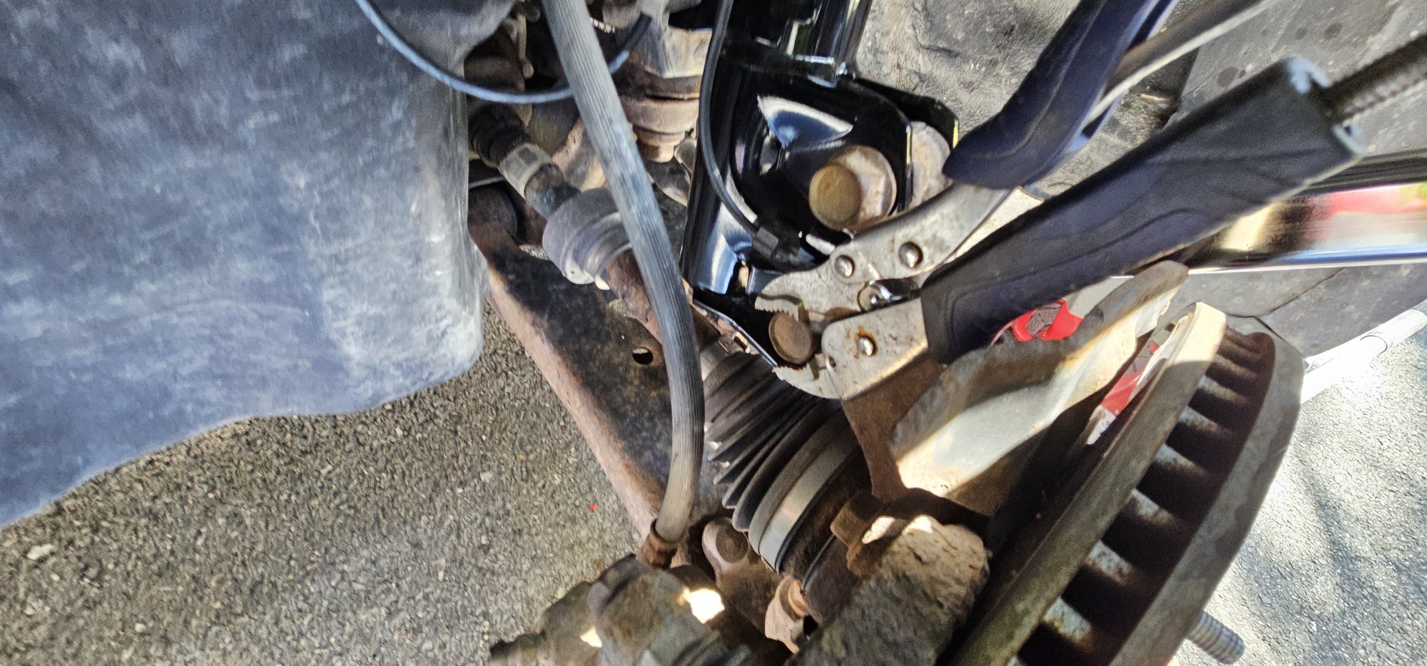

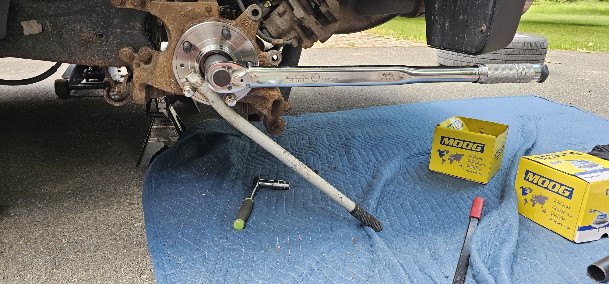

In case anyone is wondering the torque spec for the sway bar link is 55 ft-lbs. Its not actually possible to put a torque wrench on these nuts anyway. The center of the sway bar links ends needs to be held with a hex wrench in order to be tightened.
So I just guessed what 55 ft-lbs is. To me 55 ft-lbs is pretty friggin tight but not killin it.
Those big bolts which connect the strut to the steering knuckle took a lot lf torque. 175 ft-lbs.

Those large bolts wwre super hard ti break loose too. I forgot about this but I believe we removed these durimg the clutch job ti grt them out if the way. We might have used blue (or maybe red) loc-tight on there. I had to use the jack handle over the end of a breaker bar to break those loose.

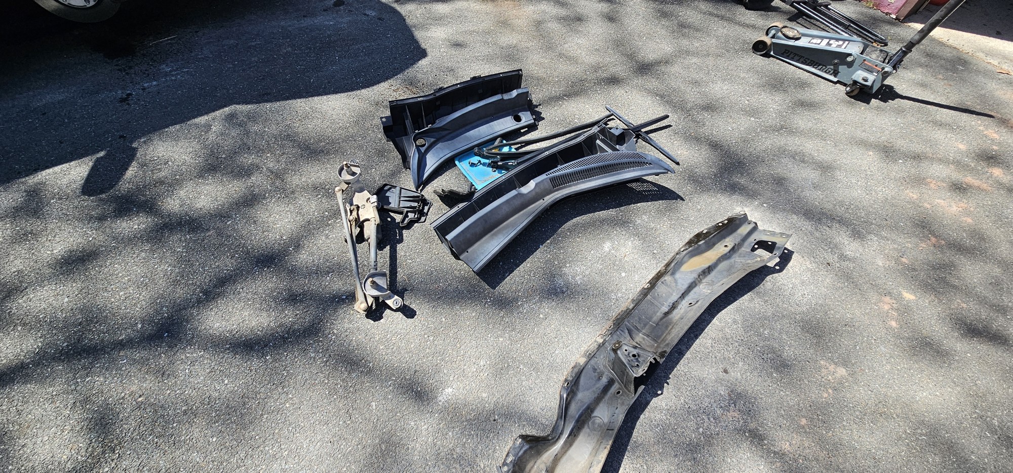

These are cowling parts. It doesnt take a lot of time to remove and makes tightening the struts much easier. I actually torqued the three top strut mount bolts to 37 ft-lbs.
I have the service manual. Its three big pink phone books.

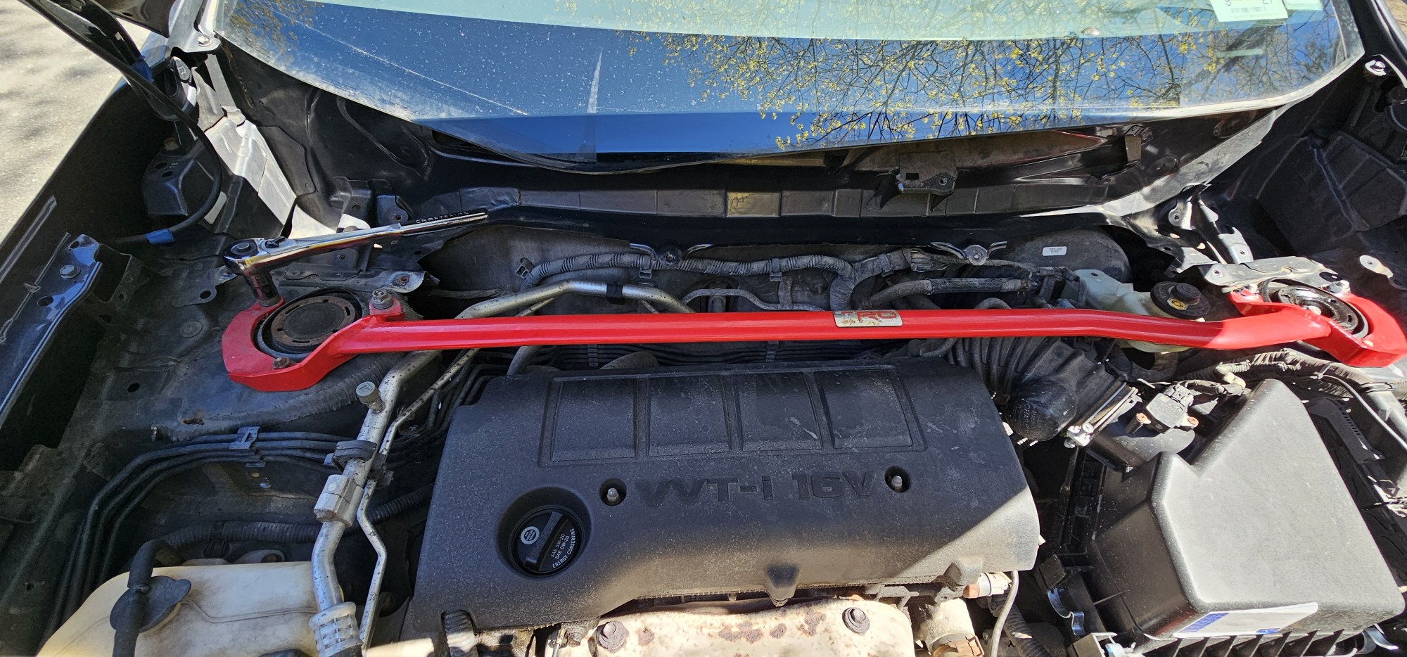

I cleaned up my old strut brace. It still looks sorta perddy.
Many many years ago after I first bought the vibe I uploaded a how-to on genvibe about to install this. Its simple really..
To the right of this pic: note the new air cleaner box. I replaced that a couple weeks ago becuase the clips which keep the clam shell held together rusted out. $80 ebay.
After I got the stuts in the car raised by at least 2 or 3 inches. The old struts were really bad. The car looks lifted on the front. It rides so nice now. It feels like its driving on pillows.
Its also much quieter. The old struts made a racket.
Ill replace the rear struts soon too. Those were already replaced once already though.. this car is sorta fun to fix.
My reason for wanting to replace the rear struts is that the car looks uneven now with just the new fronts. Perhaps the front will lower a bit once everything settles.

vibedrivermatt wrote: Sat Apr 25, 2026 1:32 pm The car has about 135k miles on it.
I'd have expected struts to last more than 135K miles. Do you think its because of hard driving, weather, bad roads, or just general age of the parts?
vibedrivermatt wrote: Sat Apr 25, 2026 2:08 pm
I once had an old 66 Falcon. mid 60's Ford Mustangs and Falcons were designed to have higher front than rear. If you don't replace your rear struts, just say you went for that "classic hungry" look
vibedrivermatt
Posts: 599
Post by vibedrivermatt »
joatmon wrote: Sat Apr 25, 2026 4:21 pmI'd have expected struts to last more than 135K miles. Do you think its because of hard driving, weather, bad roads, or just general age of the parts?
It may habe been a combination of factors. Its possible that my struts wore out faster because I had TRD lowering springs. Those went on the car when it was still pretty new. I had those one for a time until the ride became terrible. I had the car at a shop for an aligment and was informed that both of TRD springs were broken. I still had the original springs so I put those back on but kept the original struts. I probably should have replaced them then..
Later, I had brought the car to a mechanic to resolve an issue with my parking brake. I wasnt so enthusiastic to have to climb under there and fix that one myself.
Anyway, they informed me the left front strut was bad. I was already aware. They said it wouldnt pass inspection due to the bad strut.
joatmon wrote: Sat Apr 25, 2026 4:21 pmI once had an old 66 Falcon. mid 60's Ford Mustangs and Falcons were designed to have higher front than rear. If you don't replace your rear struts, just say you went for that "classic hungry" look

Nice work! ;) I have several "Metabo" brand angle grinders and they're the best tools out of all of them. I even have several scars where "stiches" used to be for the proof!
vibedrivermatt
Posts: 599
Ohhh metabo! Those are fine german power tools.. onetime I bought a metabo angle grinder for my dad.
It had a soft start.
The one I have was gifted to me. Its Porter cable brand. Its nothimg fancy but it works.

I got the other sway bar end link on the vibe today.
Heres some other fun stuff as I'm bored. It seems like I'm always fixing stuff lately. I own a rather cool hot rod. This is a 1995 nissan 300zx twin turbo with manual transmission. Ive had this car for a long time. I bought it before my vibe.. I want to say I purchased this nissan in 2004.. this car is super clean and I try to keep it that way. Right now it has about 74k miles.

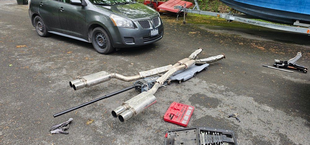

I pulled the exhaust out for some work. It was kinda too loud so I made some tweaks. It sounds awesome now. Not too loud. Aside from that exhaust system its essentially stock. Its fun. We take it for weekend getaways. ;)

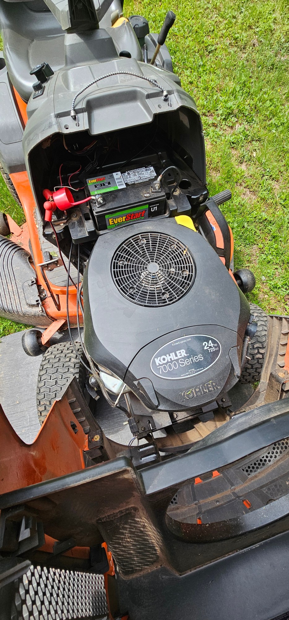

Lasty, my lawn mower is broken. The engine doesnt crank and it immediately blows fuses whenever I attempt to start the engine. The cause? I'm not entierly sure but its likely there is a short within the electrical system. The problem is, I thoroughly looked over its wiring harness and can't find any defects. It is my hope that this $15 mower blade engagement switch is the culprit. The clue? This was the last control I touched on the mower before its malfunction started. I'll find out soon if that's the fix. I hope this fixes it as my yard is beginning to look like Jumanji.
Last edited by vibedrivermatt on Mon Jun 15, 2026 4:14 pm, edited 1 time in total.
vibedrivermatt
Posts: 599
Whelp. The new switch arrived. That didnt fix the mower.. in hindsight I probably should have tested it with a multimeter first.. also, its unlikely that 20A current would be sent through that switch anyway. The mower (or yard tractor) uses a single 20A fuse. It keeps blowing it when the ignition is turned on with the key.
a new starter arrives tomorrow from amazon for $50. I'm fairly certain I'm gonna get it with that. I sure hope so. It should as Ive pretty much ruled everything else out at this point. If that doesnt fix it I'm about ready to seek professional assistance for fixing this or hire someone to cut our grass.
Ahhh! The pleasure of maintaining a mower engine.   Fuel filter, oil filter, air filter, battery and rarely spark plugs is all that it ever needs to run like a top.  Theres nothing to it.  Its analog.  No fancy computer stuff here.   Theres a relay and a fuse.  Theres mechanical linkages and a carburetor.  Thats about it.
This is a great engine. Kohler 7000 series. Very strong. This issue of blowing fuses is really its first major mechanical breakdown (of the engine) since I bought.
Those armrests are custom.  Theyre included with higher level husqvarna garden tractors and stuff.  They can also attach to this tractors seat so I ordered those for it.

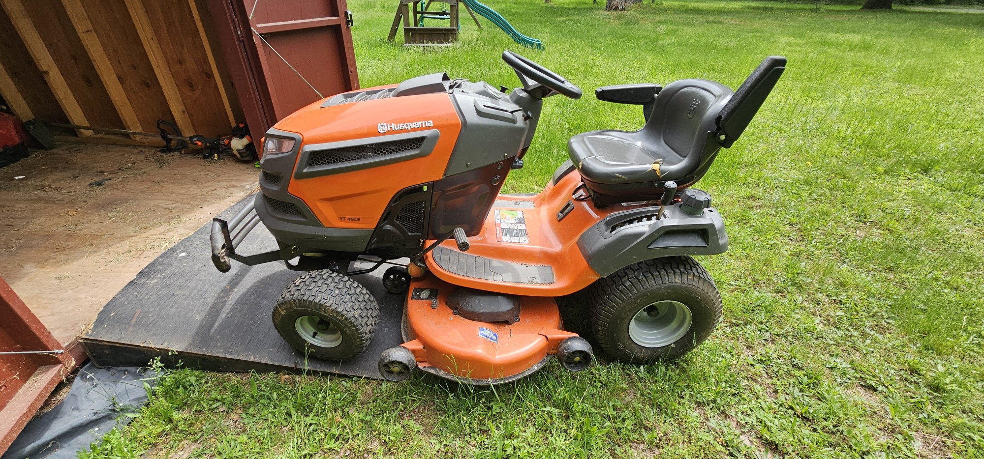

This is my mower. Its a husqvarna YT46LS. Its been an awesome little machine to cut my grass. I have about one acre of cleared lawn to mow with this. It features quick release blades. This feature has since been discontinued. The quick release blades have been pretty handy but, once I had to replace one of the quick release mechanisms on the mower deck. It was $70 for that part which was sorta a bummer. Another time, a bracket which holds the mower deck snapped off. I bought a awesome little Harbor Freight flux core wire feed welder ($150). That it fixed up just fine. It was fun to learn a little bit of welding too.
I purchased this around 2015 when I bought a house. Its been pretty great for my needs. The mower is in really good shape. It cuts pretty nice and I kinda beat on it. I frequntly tow around a yard sweeper that gets filled with grass clippings. That gets pretty hefty which puts a lot of strain on the hydrostatic trans.. tuff torq K46. It hasn't broke yet.
I know the zero turns are all the rage but that shiz was sorta too fancy for my needs.
vibedrivermatt
Posts: 599

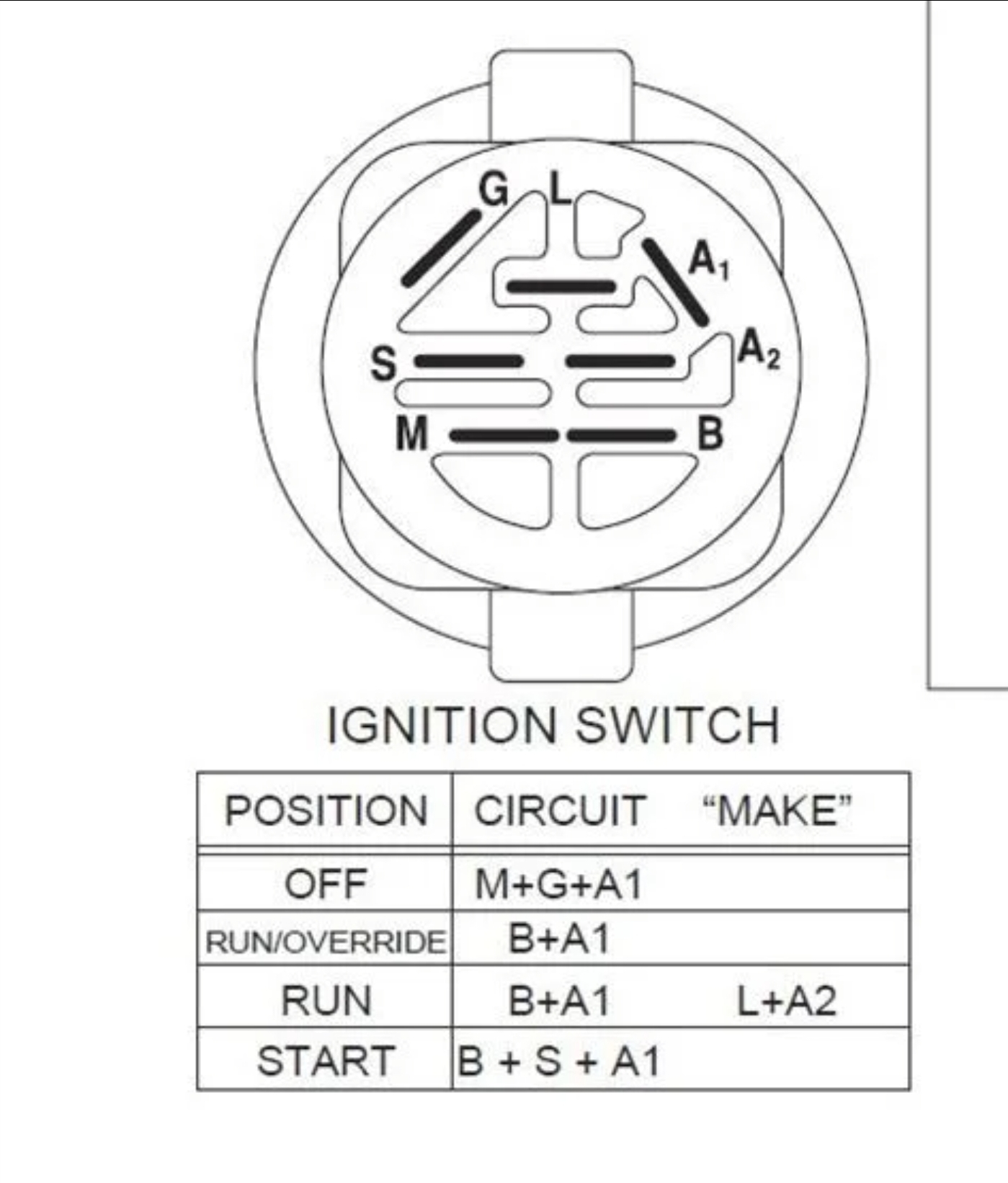

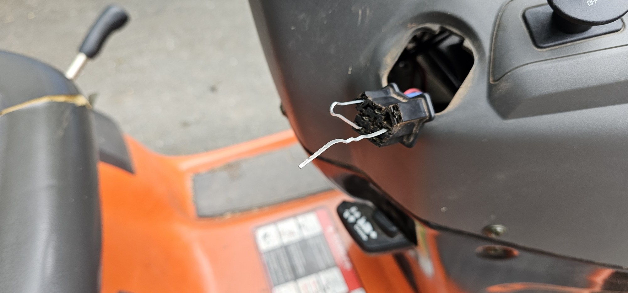

The new starter to the yard tractor showed up. That didnt fix it.. I installed a new internal starter solenoid as well. Nothing. :(
But finally. The moment lf truth.
Huzzah! Its the freaking ignition! I had to hot wire it to make it work. The tractor is fixed!!!!!!!!!
Now the tractor also has a bunch of new parts on it that didnt need replacing but whatever.. its working now. Ill order a new ignition switch for it later. For now hot wiring it will do to mow the lawn.
Its a few small cotter pins.   To crank simply touch the straight pin to the jumper pin.    Finally one of my google searches paid off when I searched up the pinout diagram for 7 prong husqvarna ignition switch.
This image show the male side of the ignition switch.  Just reverse it figure out how to hot wire the connector.
I thought I was ok at fixing mechanical stuff but this made me feel sorta dumb. I probably wasted about $85 on unnecessary replacement parts..
This yard tractor really tested my mettle..
At least I learned a some stuff. The starter and internal solenoid can be tested by shorting the big contacts on the solenoid with a screwdriver.. had I known that, I would have known not to change those. it turns out the short within the electrical system was in the ignition the whole time. And
... 20A of current does indeed flow right through that ignition switch. .I wouldn't have expected that. I figured lower current would be sent to there through a relay. Oh well. Learn something new everyday.

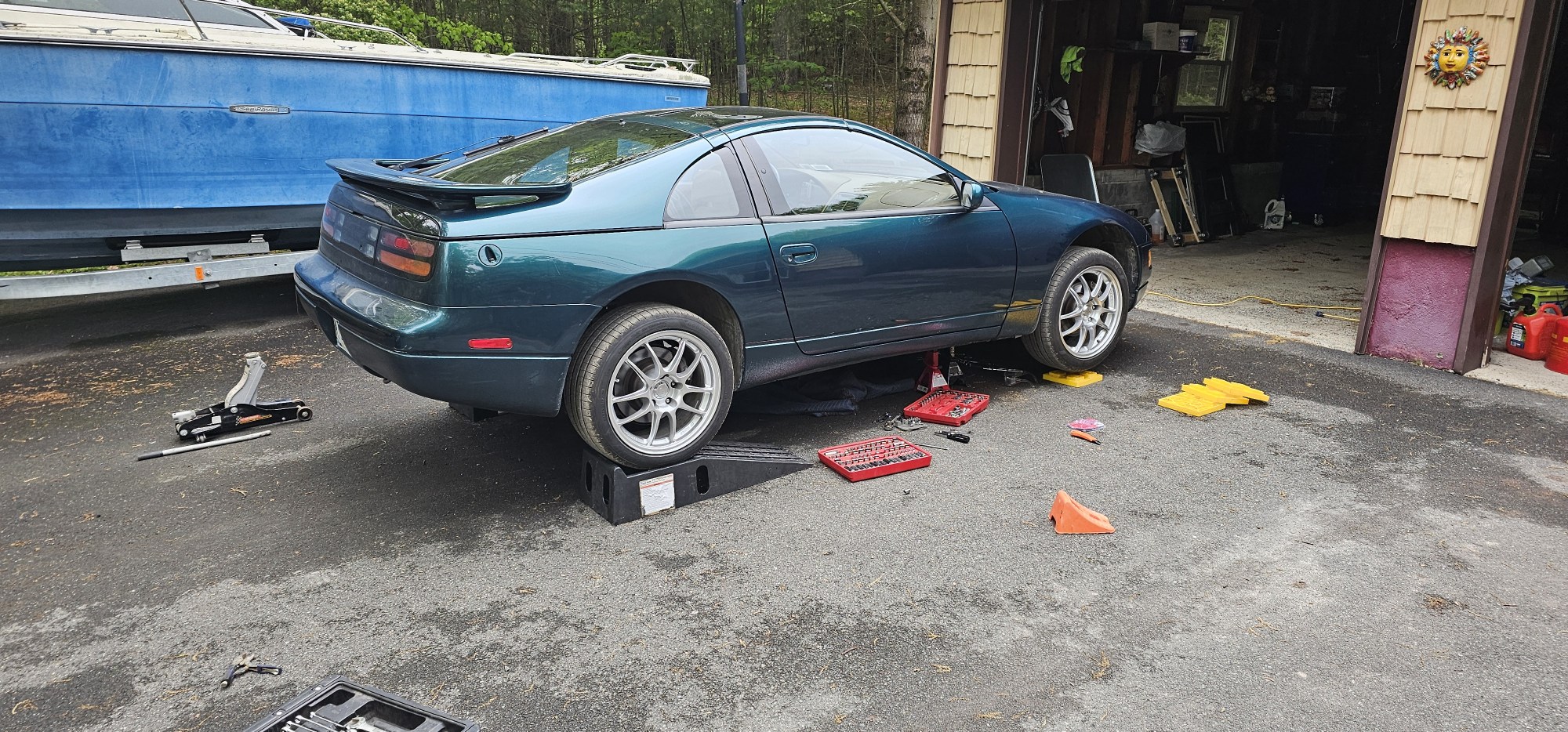

I did big job yesterday on my wifes ford edge. Once again this isnt vibe.related. still the tools and experience I picked up here may be useful if I do hubs on the vibe or other car later.
Lately, Ive taken a departue from showong vibe stuff om my garage thread buy I do plan to show more fixings of the vibe soon. My vibe is in a pretty constant state of disrepair lately.
My vibe has an electrical issue with the battery dying. I havent pinned down the cause. Also, the dial to switch HVAC vents has stopped working.

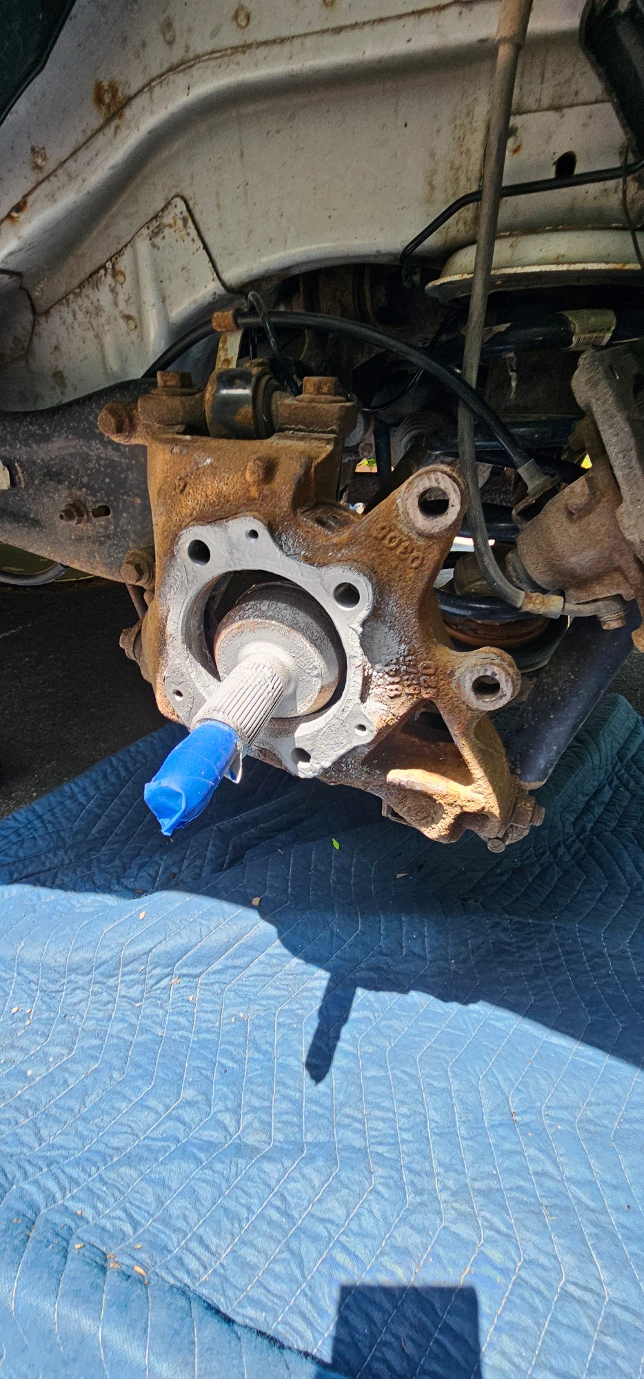

Here's doing the rear hubs on a 2014 ford edge

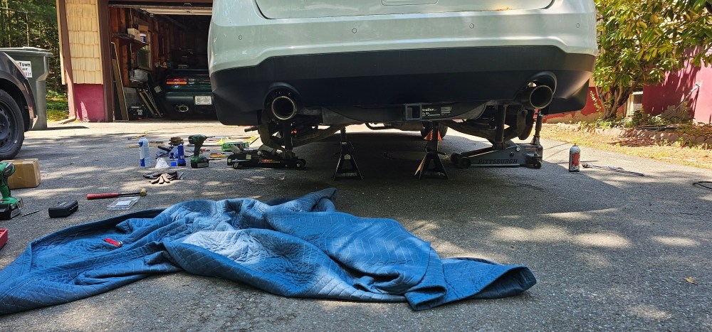

Jacked up. I found some nice stout parts of the subframe to place those jackstands. The floorjacks are left in place here to serve as a redundant safety feature.

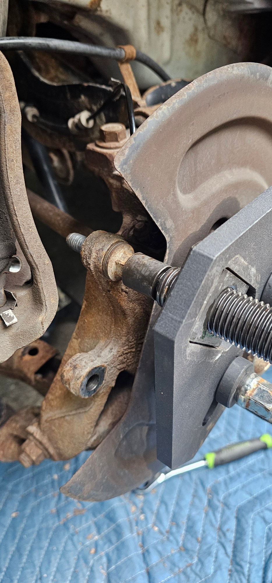

I picked up this nifty hub removing tool off ebay ($35). It makes removing the hubs go well.
One of the caliper bracket bolts can be placed backward the hole on the wheel knuckle. This provibes a place for the hub removal tool to press agaisnt.. this was still sorta a pain as my hub removal tool kepts slipping off this as I applied torque with my tire iron. After I few tries and backing the tool back out, I was able to keep it in place long enough to pop the old hubs off.
Really, if I can some sort of bolt with perhaps a cup shape on top that would work better and prevent the tool from wanting to slip off. Eventually I got it. There was little fuss.. oh btw the threads on the hub removal get a splash or motor oil for lubrication.

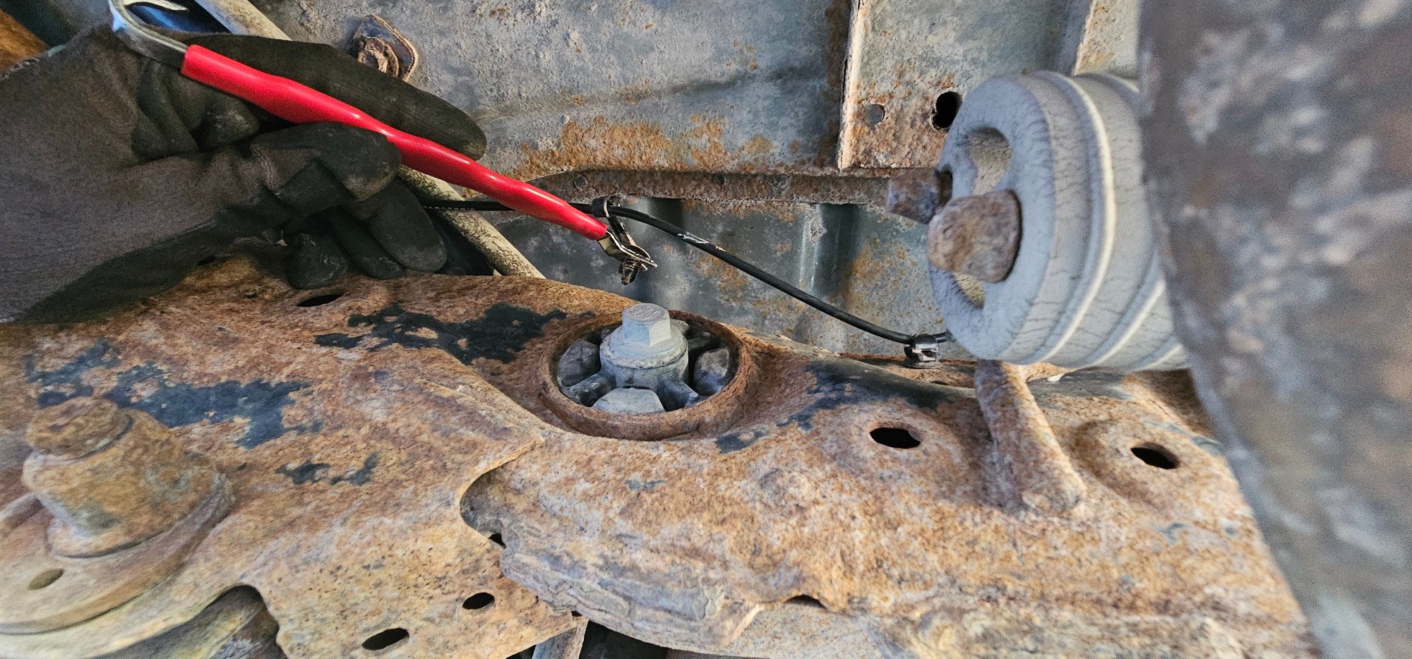

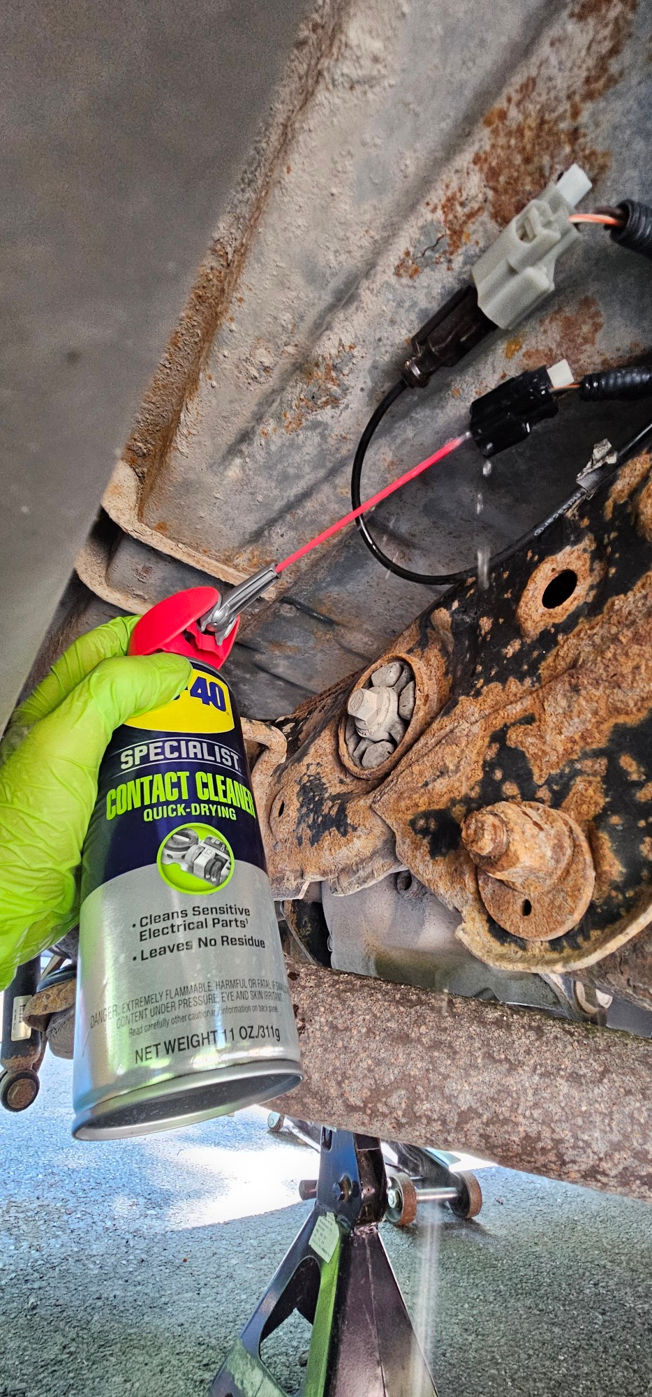

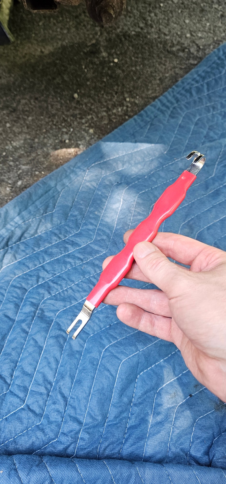

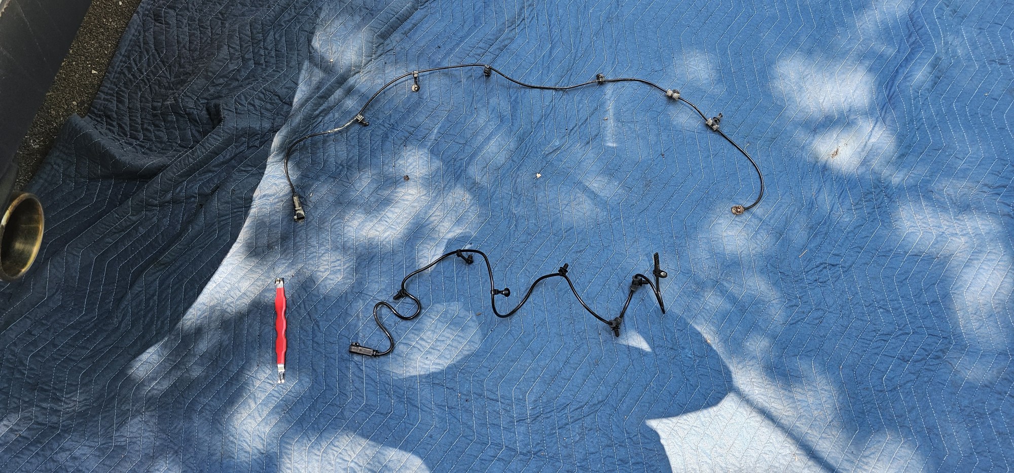

New abs sensors were required on this ford during the hub job. The old abs sensors were thouroghly fused to the wheel knuckle. I had to drill through the old abs sensors to remove them.
I ordered one of those tictoc tools off a facebook reel. This was supposed a set of 5 tools. I was really mad when I got ripped off and only this single tool was sent. It proved invaluable. I would have hated having to remove all these clips with a screwdriver instead.
Last edited by vibedrivermatt on Sun Jun 14, 2026 11:46 pm, edited 6 times in total.
vibedrivermatt
Posts: 599
This tool is really cheap and bends easily. Though in this instance it worked great. Maybe oneday ill order a nicer one.

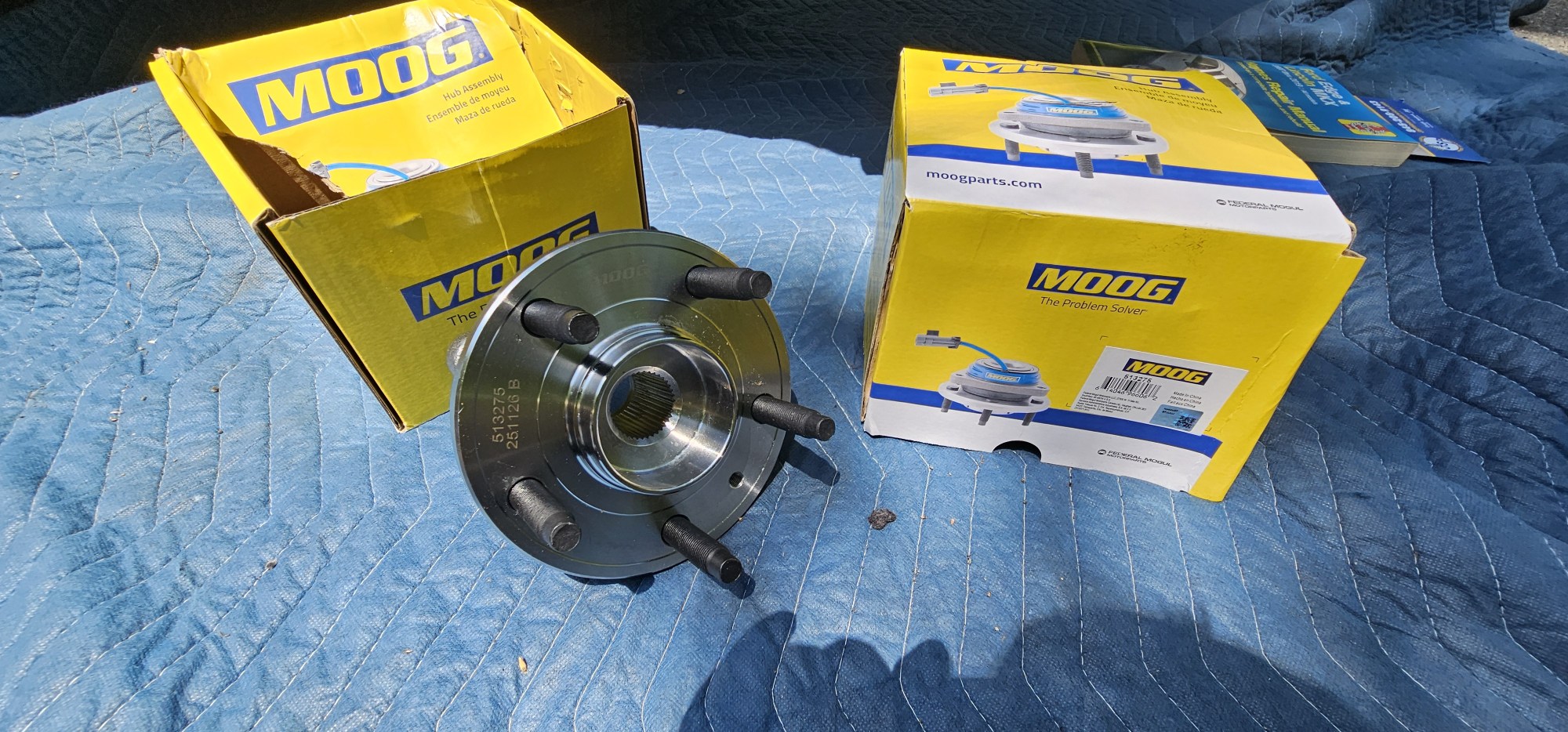

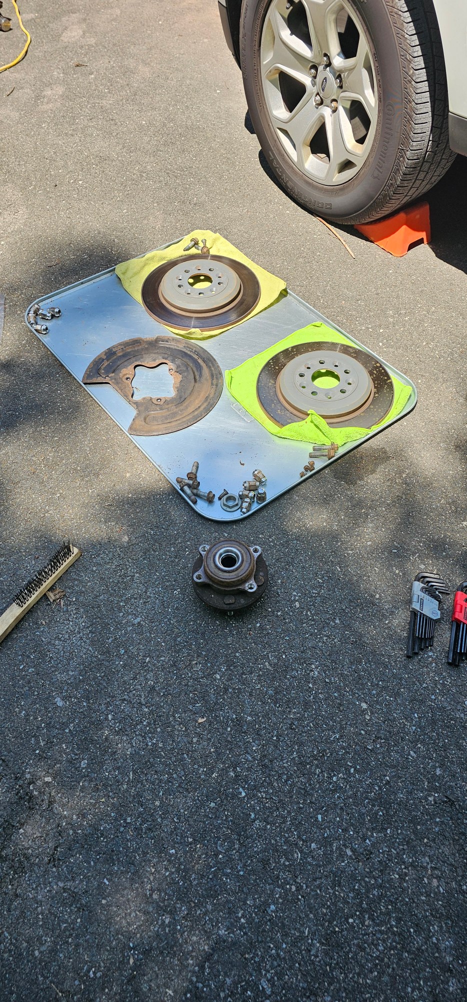

Moog hubs. $172 shipped for the pair (Ebay).

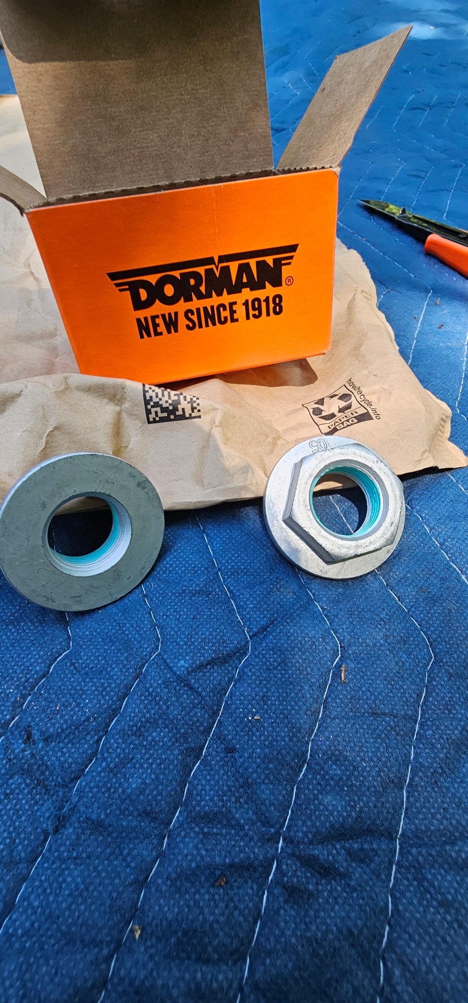

New axle nuts required here. This get torqued insanely tight.

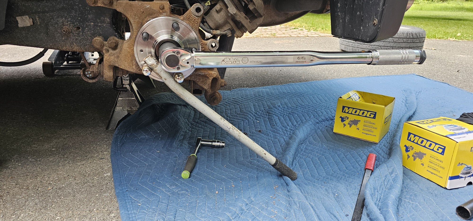

258 ft-lbs. Those are one time use. The max torque of my big wrench is maxed out at 250 ft-lbs. I just had to guess final 8 ft-lbs. Its was $15 for two rear axle spindle nuts for the 2014 ford edge. (amazon).
I order a lot off ebay and amazon.
On a side note: I have nothing against rock auto. Theyre great for searching up parts but their shipping is a little expensive. We have amazon prime. Sometimes I'll still order stuff from rock auto if that's the only way to get it.
The manual is handy. I found a typo. Its actually missimg the torque value for the 4 hub bolts which I needed.
A google search revealed those should be 85 ft-lbs so I went with that. It seemed about right. 85ft-lbs seemed to feel about what it took to break them loose.

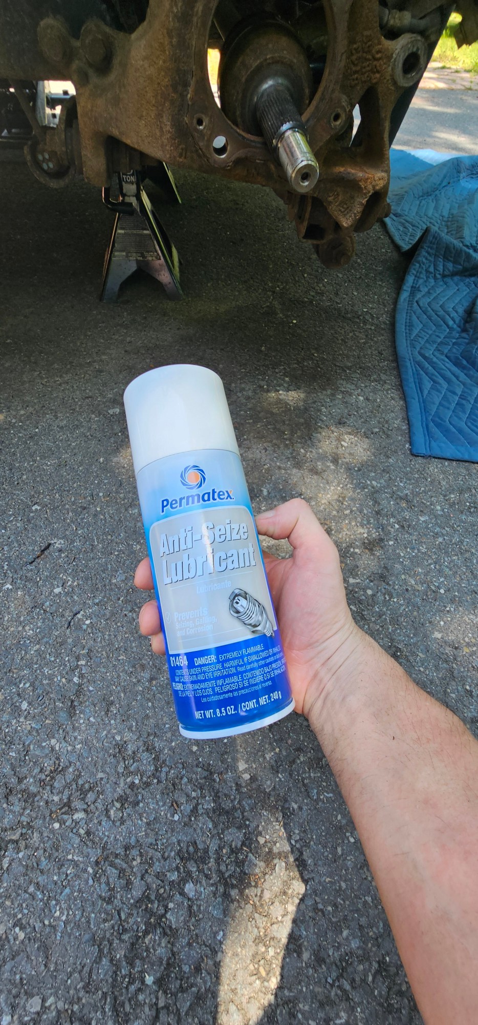

I sprayed it with permatex anti seize spray after cleaning up some of the rust. Thats just some painters tape on the axle threads. I didnt want to apply peramatex anti-seize spray there.

Thats the stuff.
Here I go torqing all the way to 258 ft-lbs. I think I'm doing a great job at this point.... do you notice anything missing?

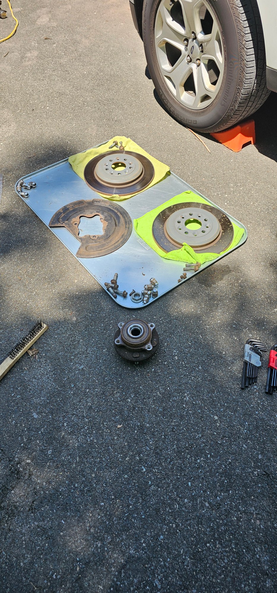

I removed the dust sheild eariler and forgot to put it back first. :oops:
Later I figured out that the dust sheild didnt need to be removed anyway..
I took this hub off again and redid it with another brand new spindle nut to put the dust sheild back on. That new spindle nut cost me $30 and an emergency run in the vibe to the nearest parts store (happened to be Napa) who had one. I had to get it done that day. She needed the car.
Its much cheaper to order those on amazon. One of parts guys at Napa did raise an eyebrow when I explained I needed the new spindle nut because I forgot to put the dust sheild on. I'm not sure he was aware that this baby goes to 258 ft-lbs. Nice guys there.
Oh well. It was 90° out and I was getting a little loopy. Mistakes happen. Sometimes you need a snickers.
Ahh the dust sheild. I should have left that on. I had this all figured out when I did the other side. It rained a little bit.
I little blast of electric cleaner spray to clean the abs connectors and shes all done. Drives great.
