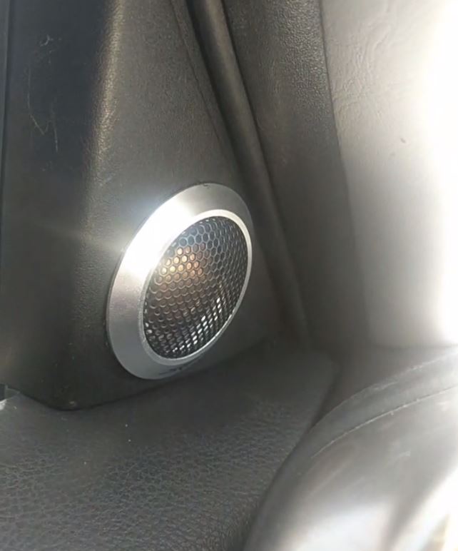

just to update, the 1in dome tweeters have been replaced from factory.
i had to remove factory tweeter bracket, purchase a flush tweeter cover (i think they're from the matrix) drilled a 2in hole and flush mounted the tweeter to the plastic cover. i then wired the tweeter using the existing harness & clip. crossover installed as well.
