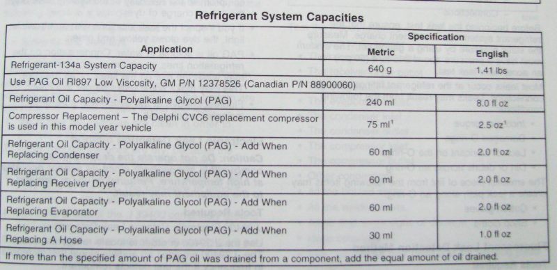

This past weekend, I wasn't really sure how to track down a small leak while the system was in vacuum, so I decided to go ahead and charge the system as well as add some dye. I pulled another vacuum for about an hour. Based on the service manual (download/file.php?id=3732), I need to add roughly 4 fl oz of PAG oil because I replaced the condenser and receiver dryer. Now, most videos I saw online say to add the oil in the yellow line (feeding into the manifold gauges) that you connect the refrigerant cans to. I attempted to do this, but 4 fl oz is a lot of oil to add into that line, so much so that I would need to add oil, charge the system a little bit, disconnect the refrigerant can, add more oil, and repeat this process quite a bit. I added what oil I could, and started charging the system. This is where things get odd. The refrigerant started going in as it should and then started to slow down. I started the car up, turned the A/C on and the compressor didn't kick on. As the system continued to charge, the compressor and fan kicked on. The high pressure side started building pressure and more refrigerant was drawn in. Then it sort of just stopped taking more refrigerant and the high pressure side stopped building more pressure. I had a scale on the refrigerant can and sure enough the weight of the can was not going down. The compressor was still running. I was hoping by charging the system I would be able to track down where the leak would be by adding some dye in the yellow line as well, but I never got that far. I am well short of the amount of refrigerant I need to add to the system and the pressure on the high side aren't anywhere close to what they should be. When it stopped pulling in refrigerant, the low side was about 50 PSI and the high side was around 75 PSI. This has left me even more confused because if I had a leak I would think refrigerant should go in no problem since it would be leaking out as well. I am really not sure where to go next.
