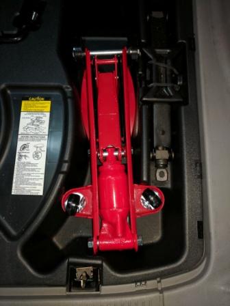

deebiv
Posts: 30
Joined: Tue Apr 24, 2007 2:16 pm
Re: HOW TO: convert spare tire well for REAL jack
Post by deebiv »
The Harbor Freight 2 Ton Compact Trolley Jack will fit in the cargo compartment with zero mods.
http://www.harborfreight.com/2-ton-comp ... 68783.html
You can dremel off some plastic or grind the wheel "wings" on the jack, but is not necessary.
Some of the plastic ribs on the cargo lid underside will be bent, you can trim if too tight.
The key is to place the jack in upside down and confirm the lift arm is fully retracted.
The jack can be found as low as $20 with a coupon or other sales.
Post by petervivian »
deebiv wrote:The Harbor Freight 2 Ton Compact Trolley Jack will fit in the cargo compartment with zero mods.
Thank you for sharing. The only concern is the short warranty (90 days).
deebiv
Posts: 30
Post by deebiv »
It appears some of the units suffer from "infant mortality", if purchasing I would suggest to leave it under load overnight protected with jack stands to test the seals; this is what I did. Seems normal and will try to use a couple of times a year to keep it fresh.
