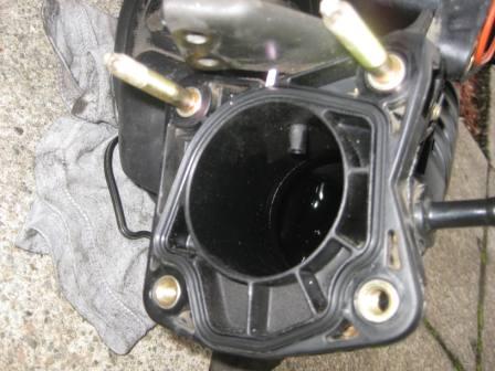

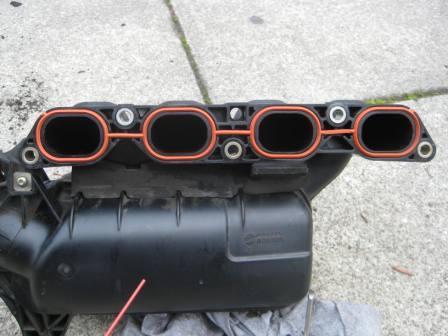

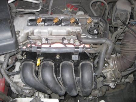

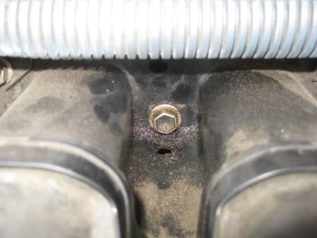

A few pictures of when I changed out the intake manifold gasket and throttle body gasket today on my base 2003 Vibe.
Dirt accumulating around center bolt at intake manifold gasket. This is why I suspected that the intake manifold gasket was bad (in addition to the fact that I knew it was the older black one). When it is cold out, the vibe does the idle hunting thing. Hopefully this replacement cures it.
ManifoldGasket 003.jpg (21.73 KiB) Viewed 31595 times

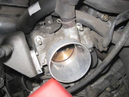

Input side of throttle body after removing the rubber hose (snorkel) from air box. Very clean.
ManifoldGasket 014.jpg (25.68 KiB) Viewed 31594 times

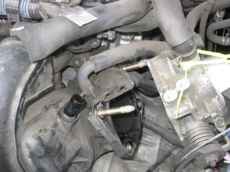

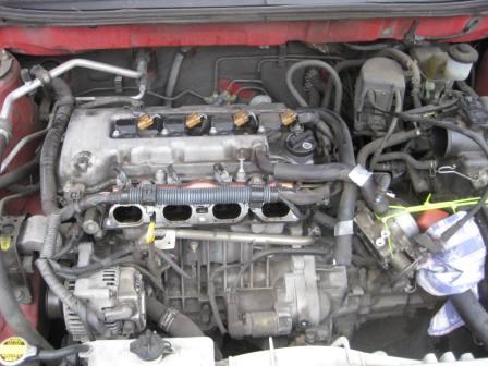

Throttle body removed and tied out of the way. I did not detach any vacuum hoses or radiator fluid lines from the throttle body.
ManifoldGasket 015.jpg (29.15 KiB) Viewed 31594 times

Post by biodieselrabbit »
Whole engine bay with intake manifold removed.
The vacuum hose you see is the one most people forget to reattach to the intake manifold when they reinstall. In total, I removed 3 vacuum hoses from the manifold to completely take it out (did not unhook any from the throttle body).

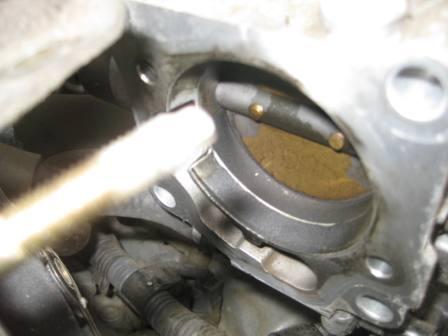

Taking a look inside.

New intake manifold gasket (Toyota Part #17171-22060). Notice how it is the burnt orange color.

New throttle body gasket (Toyota Part #22271-0D030). The old one was likely fine but since I was taking it off anyway might as well put in a nice new one given the relatively low cost.

I will report back in a few weeks about whether this fixes my idle hunting problem. Thanks to all those who blazed the way and documented their work. It made my replacement much smoother.
Reassembled Engine.
Reassembled Engine.
ManifoldGasket 029.jpg (30.59 KiB) Viewed 31593 times
