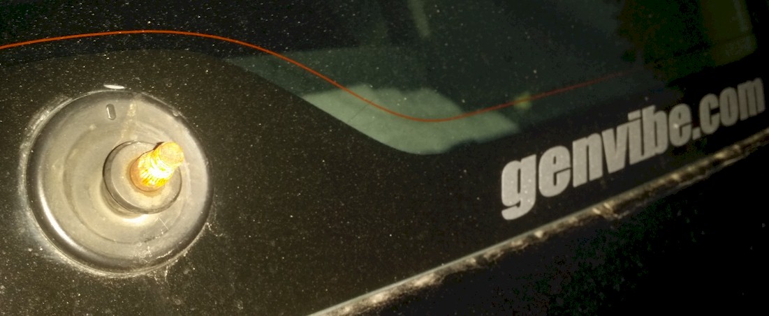

I've been trying a few times last year to remove this nut but it seems stuck or has been tighten way too much... I don't want to break the window while trying to get it out...I don't want to remove the wiper, I only need to paint the finger tab cuz it lost all the black plastic coating on it and turns out ugly greyish cheap metal...
2005 Lava Vibe base Garage
A Psycho Martyr
Posts: 2598
Location: Cullman, Alabama
Re: How to Remove Rear Wiper Assembly (BadBrew)
Post by A Psycho Martyr »
Quote, originally posted by BadBrew » I don't want to break the window while trying to get it out... I just used an adjustable wrench to get mine off. I think no matter how tight it is you'll be safe takinjg it out tho. There's a big piece of rubber in between the metal and the window. So no metal is touching glass. I mean don't hold me responsible if something goes wrong, just from MY experience I say go ahead, give it some elbow grease..Give it another shot when the weather permits and lemme know how it goes.

A Psycho Martyr, you didn't mention in your original post that the nut holding the little window opening tab is reverse thread. I just mangled mine to pieces trying to get it off. Only after did I read some old threads and discover this problem. From what I read, the nuts on the black buttons on the window are also reverse thread. If this is so it may be worth editing your original How To.
A Psycho Martyr
Posts: 2598
Re: (Raven)
Sorry to hear about your parts getting messed up If I had noticed that during the removal I would have put it in the tutorial. I will go back and edit it tho to warn ppl.I have no way of checking mine since I sold it, but maybe Persephone will let us know if hers was reverse threaded.

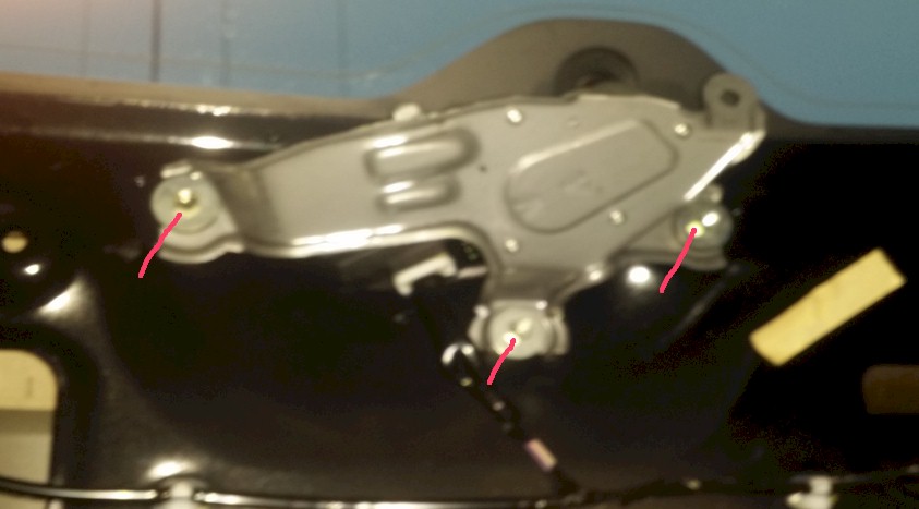

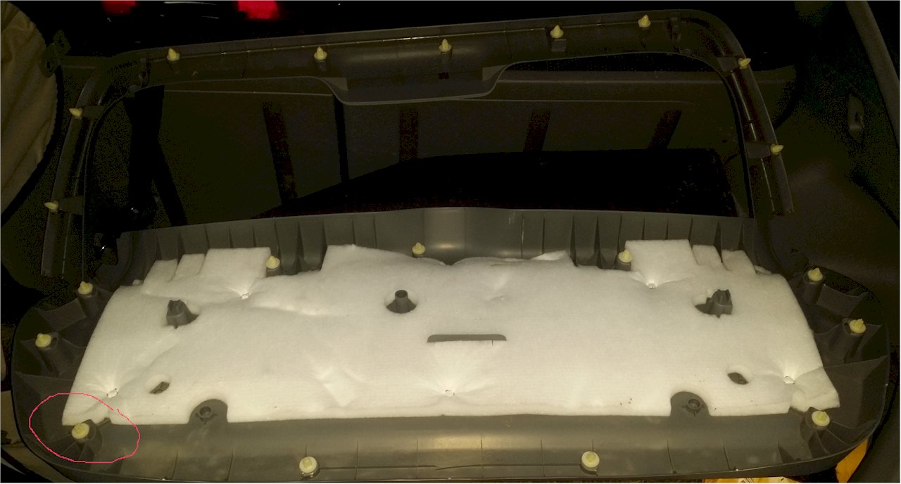

for gen2, the process is a bit easier
There is a nut under the wiper blade arm cap, but no more nuts after that (likely because you can no longer open the glass). My nut was badly corroded and it wasn't easy to remove. If you put to much pressure on it, it will start turning the wiper arm crank spindle which will likely not make the motor/gears happy if you are going to use it again.
You'll need a way to plug the whole after. I'm debating putting a rear camera in this spot.
The Hatch Panel cover is all held on by plastic push rivets. There is a small indentation on the bottom left to gain access to pry the first one; it all pops off easily. [This is a good time to add some extra noise insulation. I'm going to beef up the insulation used, put some dynamatt like strips on both the plastic cover and metal hatch, and put some rub strips between the spots where the plastic panel members join together.
The wiper motor is still mounted on a bracket held on my 3 10mm hex bolts. You can remove the whole bracket as it doesn't attach to the plastic cover, and take off the whole assembly after disconnecting the power connection.

Does anybody know what that final nut on the outside of the window's size is?
Mine is super seized (spindle too, and that's probably why the wiper doesn't ever move anymore), and I tried using an adjustable wrench and that just started destroying the nut, so I think I need a bit more of a "proper" tool to use..

Wouldn't it be easiest to throw sockets on it until one fits?
pGVa
Posts: 13
Joined: Mon Nov 07, 2016 7:53 pm
Re: How to Remove Rear Wiper Assembly (Tutorial)
Post by pGVa »
Sorry, forgot to mention that I did do that and my set didn't have anything big enough.
