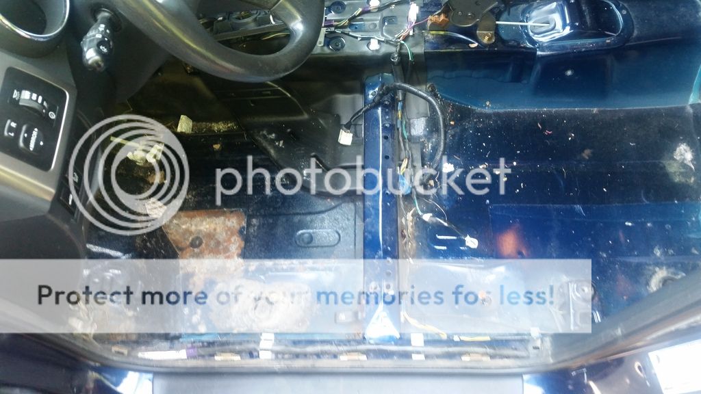

Well I bought this vibe about two weeks ago I love it so far. It is my first stick it has 193k on it but runs great third gear is going to get fixed because for some reason it pops out when shifted into third. So far all I have done to it is do a very deep cleaning oil change and wired in a led strip under the hood to light up the engine compartment at night. Anything you guys recommend or think i should do. Here are some pics.
Re: 2005 neptune vibe slow build
Now that you have the carpet out put in some sound deadener. You can find brush on stuff on line or you can get the Peel and Seal from your building supply store.
The carpet cleans up real well with Bissell carpet cleaner and a scrubber. You don't need a carpet cleaning machine if you have a wet/dry shop vacuum. OTOH a carpet/upholstery cleaning machine would be easy enough to rent.
Keep us posted with your progress!
