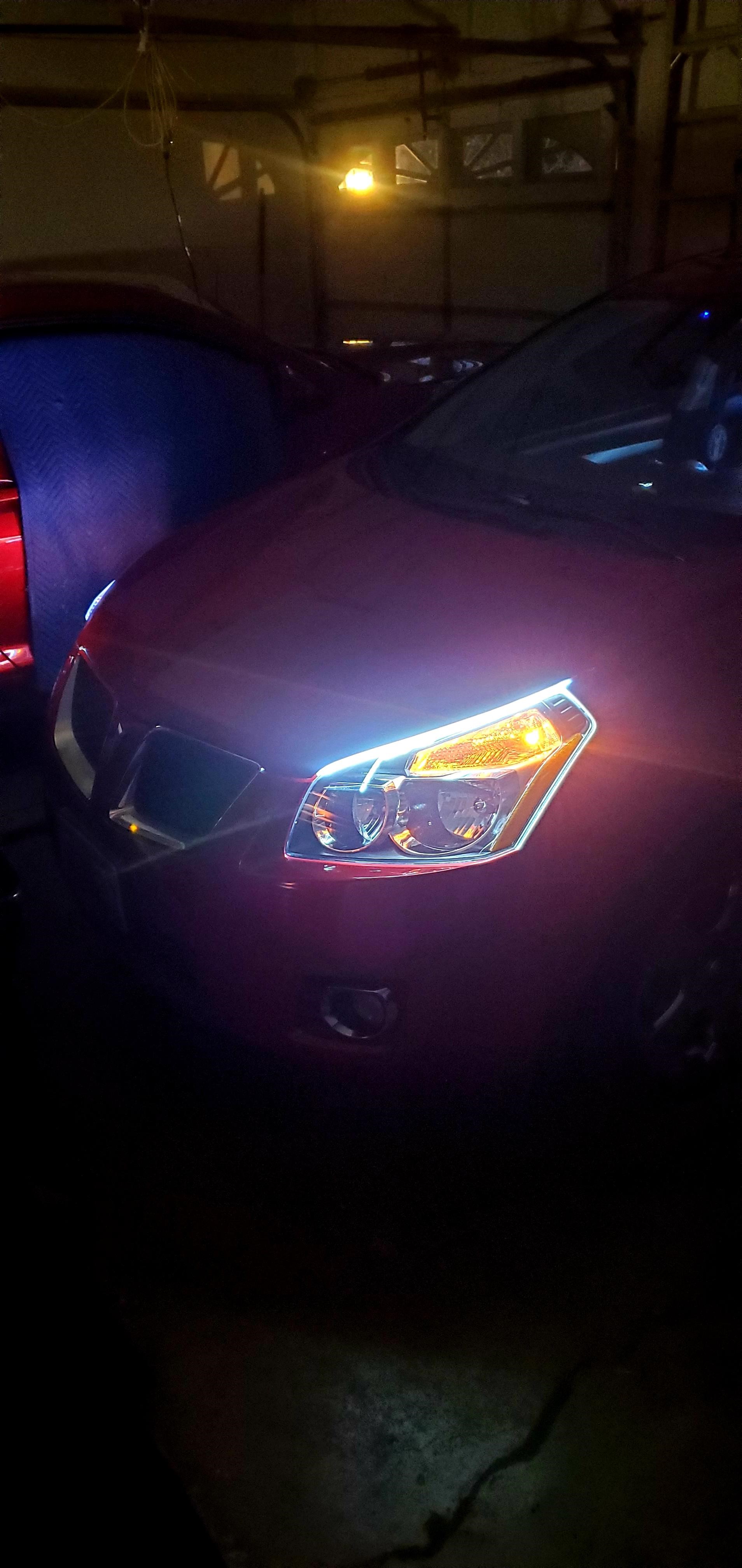

I recently cut the blue wire behind the glove box to allow my headlights to accept LED headlights but wanted to add DRL back in another form.
Purchased these Ribbon LED's from a website and piggybacked a fuse in the Fuse box to go on when car starts. Also tapped side turn lights. These DRL turn to sequential Yellow turn signals when activated, then return to white when done turning. Fit perfectly above headlight lens between hood. Great mod for under $10 total.

Re: 2009 Vibe 2.4 Daytime Running Light Mod
Post by Lacpac »
