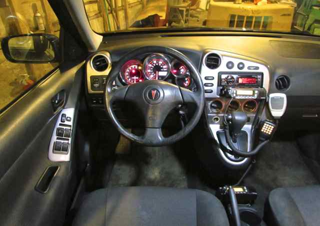

Finishing up project "Hurricane Overdrive". Image
2005 Neptune Blue Auto Moon and Tunes, with what appears to be a near full set of options. Previous owner had dealership add undercoating, clear coat, and scotchguard
Finally had a day where it wasn't snowing, and sunny
After modding the inside, new tunes and added 2 way radios

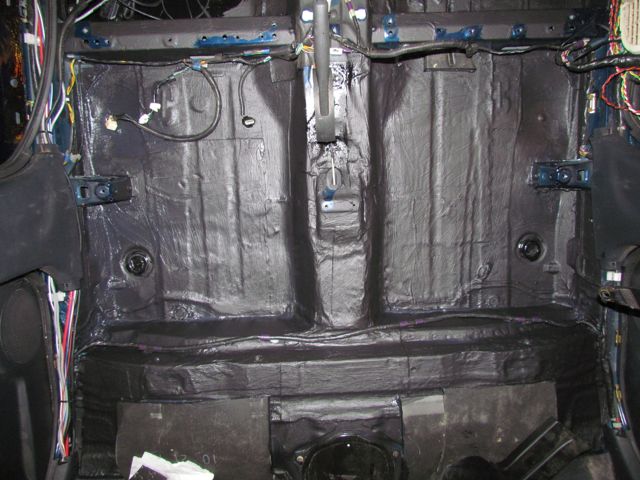

-Removed most body panels and added sound deadening / sound isolation
-Took back seat bolts loose, lifted seats, cleaned and added sound deadening

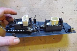

-Added lights to console, dash, and under seat: viewtopic.php?f=18&t=40690#p482447"

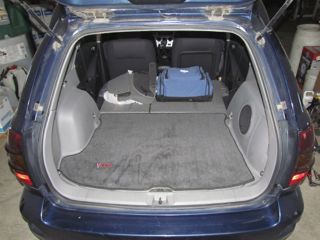

-Bought rear cargo carpet from '06 Moon and Tunes owner, the trick now; keep it clean.

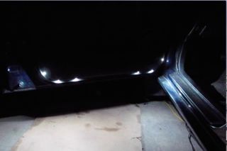

-Added ground clearance / courtesy lights to doors viewtopic.php?f=18&t=42843"

-Finished adding sound dampening material and tune audio system, midbass slightly weak. viewtopic.php?f=30&t=40549&sid=e7615f8b ... 4e#p508765

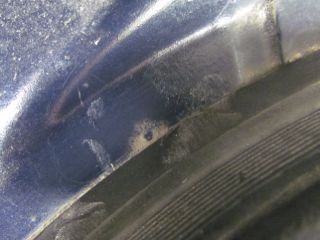

-Fixed seeping tire, aluminum rim corrosion causing slow leak

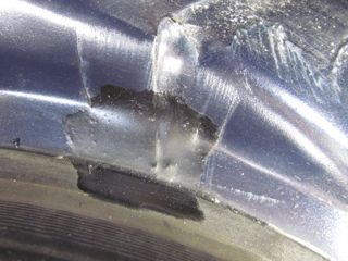

-Fixing stone chips on hood, many starting to rust, used Por-15 Black, which blended with Vibes Dark Neptune finish

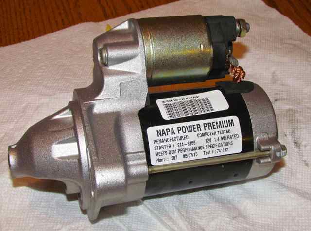

-Replaced original starter at 200k miles viewtopic.php?f=30&t=40549&sid=e7615f8b ... 4e#p509040

Finally got some POR-15, so now just need a warm day to start filling in the stone chips on the hood.

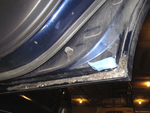

Found bottom of rear passenger door starting to rust, along the door skin panel seam. Appears few small spots over time rusted along the seam until it become a line of rust. Found a few more spots on this door. Ground out the rust and painted with POR-15 black, also found a few small spots in the hatch area. With the tailgate open they were near the weather stripping. Caught it before it blistered the paint, so spot coated with POR-15 Appears as the road salt lingers in these hard to clean areas and is doing its damage. Pic of the door, will try to post the tailgate area rust later.

Also put in the Moon and Tunes Cargo carpet, Fits Great! Still see it being offered new at some GM sites, but found an 06' mat on eBay for the right price. Now the trick to keep it clean.

Getting ready to do driver side door mod. Looking over posts going to go for three things in one shot
-Ground light, when door is opened
-Illuminate window and lock buttons
-Turn signal indicator in mirror.
Found these posts:
Mirror:
viewtopic.php?f=33&t=15103&p=465132&hil ... rn#p465132" onclick="window.open(this.href);return false;
viewtopic.php?f=33&t=33213&p=386012&hil ... rn#p386012" onclick="window.open(this.href);return false;
Door Buttons:
viewtopic.php?f=29&t=41380&p=486023&hil ... ht#p486023" onclick="window.open(this.href);return false;
Anyone have any tips or information before beginning to take the mirror and switch panel apart?

Project has been in the works for a while, finally had both time and weather on my side. Upgrading the lighting package on the Vibe. Below are several links to posts showing individual items that can be tied together for one package. How many LED's can you fit into a Vibe?
Taking doors apart to add or modify items:
http://www.youtube.com/watch?v=_Xcc4HZO7wE"
Adding extra wiring to your doors:
LINK: viewtopic.php?f=18&t=42830"
Adding Ground Clearance Lights:
LINK: viewtopic.php?f=18&t=42843"
Interior console and foot well lights:
LINK: viewtopic.php?f=18&t=40690#p482447"
Turn signal indicator in mirror:
LINK: viewtopic.php?f=18&t=42845"
Adding Panel lights to door switch panel and door handle
LINK: viewtopic.php?f=18&t=43488"
Roof Bar Lighting options:
LINK: viewtopic.php?f=33&t=42852"
Rear Hatch Lighting bottom area with cargo cover installed:
viewtopic.php?f=18&t=43537"
Ground Effects!
So how many LED's can you fit in a Vibe? Image
Only ran into a few major issues, unexpected rust behind the mirrors and on the roof rail mount bolts. Having to drill out a screw in the mirror, again due to rust. The headliner in the car being extremely snug (this is a good thing, but makes routing wires hard)

Getting ready to put the summer wheels on, noticed a giant hole in the front driver side plastic inner fender well. Ordered the replacement, came smooshed in a box. Set it out and it "expanded" back to the correct dimensions.
http://www.ebay.com/itm/110977430931?ss ... 1439.l2649" onclick="window.open(this.href);return false;
Getting ready to make the repair, will post notes and video when done.

Weather finally suitable for painting. Working on coating rust, aka the War on Salt. Although suspension parts rust, my main concern is all the supporting hardware, brackets, bolts, tabs, etc. When they start rusting they make a real mess, bolts that take forever to remove, brackets and tabs that rust through allowing the attached items to float in space. Pictures show "pocket" in front of rear tire that accumulates dirt/salt. Treated and painted the brackets supporting the brake lines (including fittings), emergency brake, wheel sensor, and body panel. The metal edge were the rocker panel is welded to the floor was starting to rust, especially near bends and spot welds. Also saw a few spots on the brake lines were stone chips were starting to rust, coated brake and fuel lines to prevent rust. Trying to prevent issues seen on older cars, especially brake line failure. Under the hood doing the same, brackets, bolts, and mounts.
Using three step POR-15 process. Metal prep solution, two coats of POR-15, top coat
Before and After

While the interior is out, added 2nd phase of sound deadening. Can't wait to get it back on the road and see how much this improves the interior audio quality. Placed a layer of Constraint Layer Vibration Damper - CLD, then coated the hard to get areas with acoustical undercoating, plus touched up under the car where I worked on the floorboard. Will cut new encapsulated sound dampening padding to fit the interior, replacing the OEM fiber "sponge" originally used. Hope this will help protect the floorboard and prevent moisture accumulation under the carpeting.

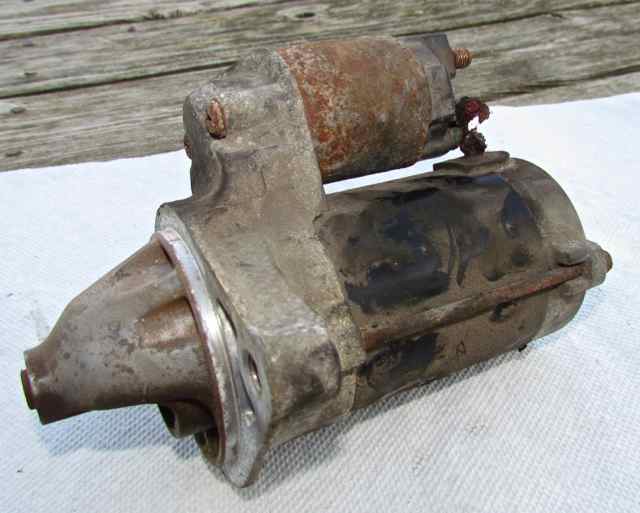

After getting the floor board repaired, went to run a few errands to enjoy the many added enhancements. After the fourth stop.... the car stopped. Turned key, starter spun for fraction of a second, then no go. :o Have lights in the dash, all electronics seem to function OK, but starter will not go. After about a half hour checking fuses and tapping on the starter, made the call for help from a few of my friends. After getting the car home, removed the starter and saw the following, can you identify the fail? I think this is what causes many of the starter sudden deaths mentioned on this site.
The wire off the solenoid to the starter is bare copper! I am surprised it lasted this long 10 years 200k miles. With all the salt and proximity to aluminum car parts the wire turned into a fusible link, once enough strands rot away the remaining ones take the load until "poof" no more connection. What was an otherwise great running starter was stopped by its Achilles heel, exposed wiring. Got a refurbished starter, saw the same exposed copper, treated it with anti-seize to prevent corrosion, also put a little on the surface mating to the engine to make future replacement easier.
Thanks again to the many posts on this site, made replacing the starter a breeze. Would have replaced the starter in the parking lot, auto parts store was at the opposite end,.... but it was closed. Overall the starter is not that hard to replace, just need the right length extension to reach the starter bolt coming from the transmission housing.
Re: Derf 2005 Moon and Tunes Deluxe
wow!
I think I will be under my vibe tomorrow putting a little grease on the copper.
Hmmmm ... Interesting yet "poor" design of a starter. I would thing a solid copper bar connection would have been better? Maybe there is some "flexing" that takes place with every start to where they needed stranded copper? Maybe it makes for an easier assembly of the part? In any case it was an easy fix for you and glad you back up & running :D

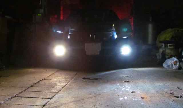

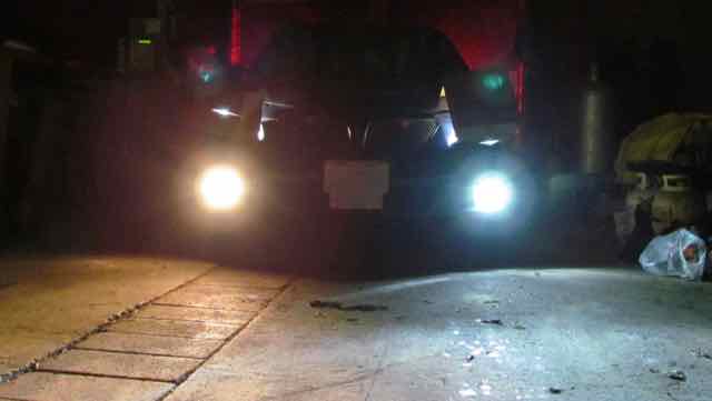

Finally had a chance to finish converting lights over to LED. Installed multi function fog lights. Flipping the fog light on and off within a few seconds alternates modes. Left bulb is halogen, right is LED stepping through modes. (Put boxes over headlights for better fog light comparison)
White
White/Amber Blend
Amber
Overall the LED 9006 assemblies I purchased are not as bright as the halogen equivalent. I seldom use the fog lights, was instead looking for purer light without blinding oncoming traffic. Several reviews indicated amber light helps enhance contrast in the fog. Will have to try it out. Part used for the conversion
Interchange Part Number: 9006,9012,HB4
Color: 6000K White / Amber / 5000K White (Mixed Color)
LED Type: 4 CREE XB-D LED High Power
Power: 10W
Actual Lumen: 170 Amber / 570 White
Dimension: 62.57mm Length, 18.5mm Diameter

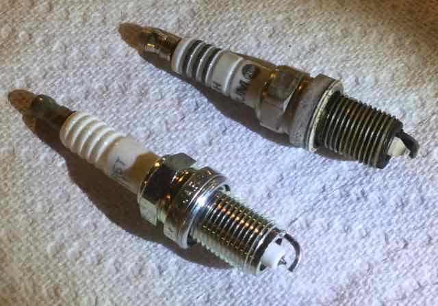

Big day, completed valve lifter tolerance check, replaced leaking chain tensioner o-ring, compression test, and installed new sparkplugs. Converted car to Winter mode 202k miles. Hard to pass up 51*F shop day in Jan
The old plugs (top) were a Bosch platinum number, odd tip design the ceramic goes all they way to the tip, unless most of the electrode has arched away. Installed NGK 4996 IFR5T11 iridium plugs (bottom). I wonder if the previous mechanic realized their was an OEM label on the valve cover recommending iridium plugs
Vibe_NGK_Plugs - 1.jpg (31.83 KiB) Viewed 32888 times
