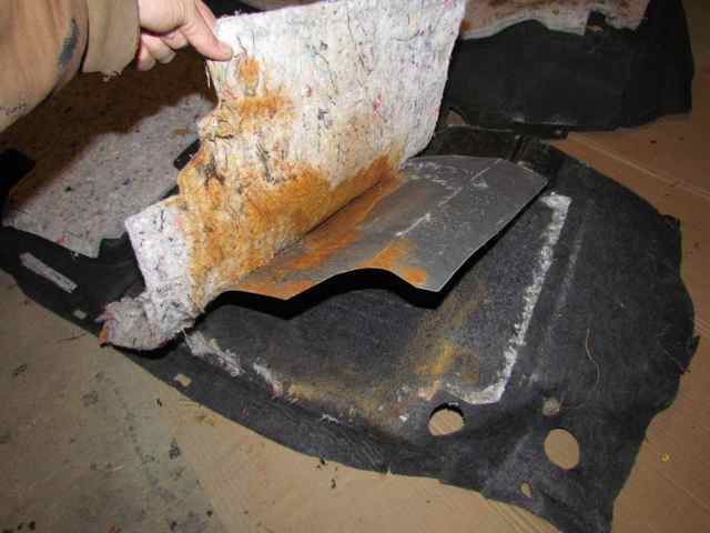

Recently removed the interior to clean, sound deaden, fix issues, and run more wiring. Saw a few posts about work that required removing the interior, wanted to supply details on removing the interior. As the Vibes age and trade owners, some surprises could be lurking under the carpet.
Video showing basic steps to remove and install the carpeting 2003-2008:
https://www.youtube.com/watch?v=mAVkr4WpqWU
Horror under the carpet,... it only took three weeks to fix all the rust :o
Got some ideas from this previous post where member detailed removing the carpeting and rear seats
viewtopic.php?f=29&t=36163&p=404808
What horrors did you find under your carpet? Any tips or special projects while your interior was out?
