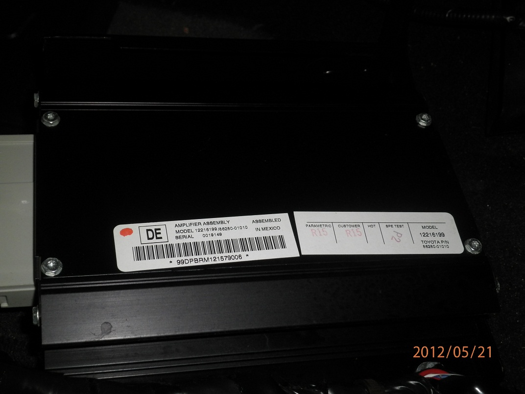

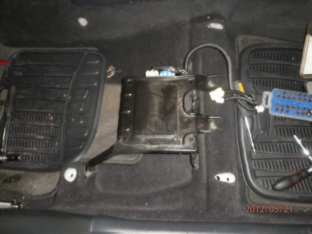

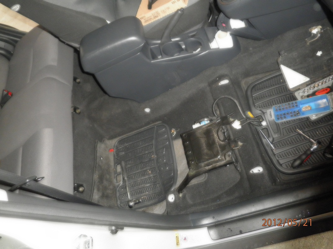

1. Disconnect the negetive battery terminal!!! Locating the factory amplifier. This is the easy part, it's underneath the passenger front seat. Remove the 2 front bolts that holds the seat down and then put the seat all the way to forward position to reveal the 2 rear bolts at the back that are covered by the plastic trims. Once all the bolts are removed, disconnect 2 electrical connectors under the seat and unclip the clip from the seat frame. You will be left with this:
Now remove the integrated amplifier by removing the 2 bolts towards the front and 1 towards the rear, and you'll be able to detach the integrated amplifier from the car.

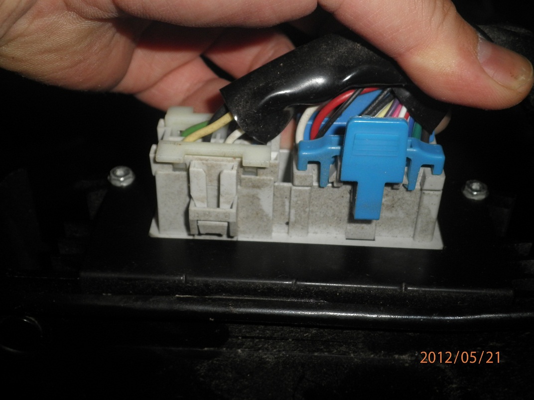

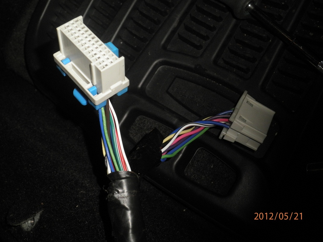

2 sockets are plugged in to the integrated amplifier, 1 with 8 pins and the other with 24 pins:
I also found a wiring diagram (posted by playzkeyz on another thread). From the wiring diagram, I was able to guesstimate which wires are for what. Look at the diagram closely and you'll see the top 'box' labelled 'PPL' (purple) as left front output negetive (LF-) and 'PNK' (pink) as left front output positive (LF+) and the rest of them are 'BLU' (blue) as RF-, 'LT GRN' (light green) as RF+, 'YEL' (yellow) as LR-, 'BLK' (black) as LR+, "WHT' (white) as RR-, 'RED' (red) as RR+. These wires takes care of the speakers output from the factory head unit to the input to the integrated amplifer, and the output from the integrated amplifier to the individual speakers are also the same color.

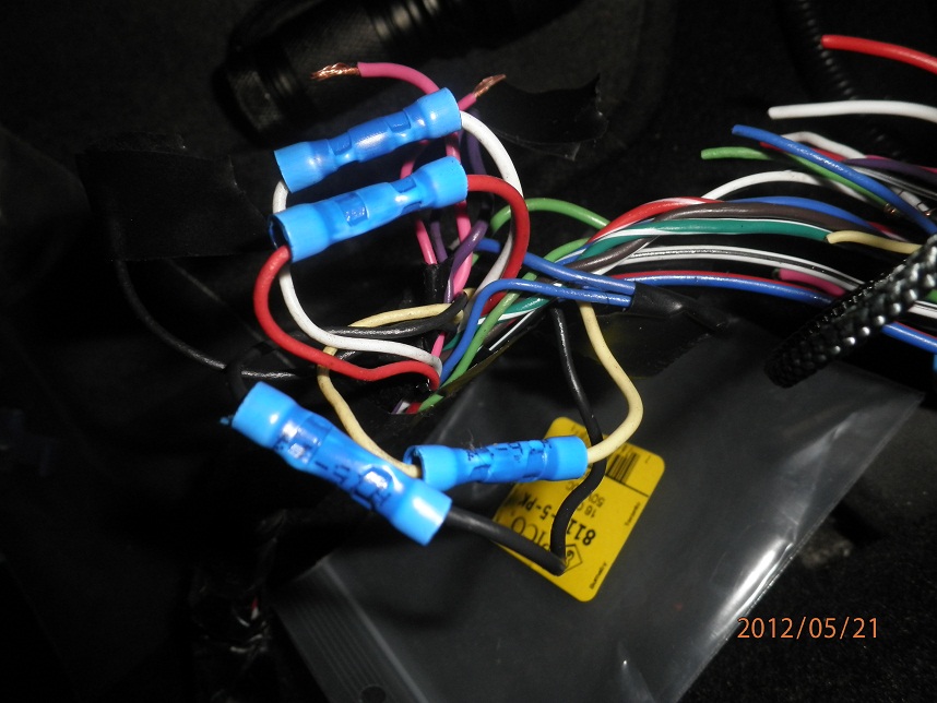

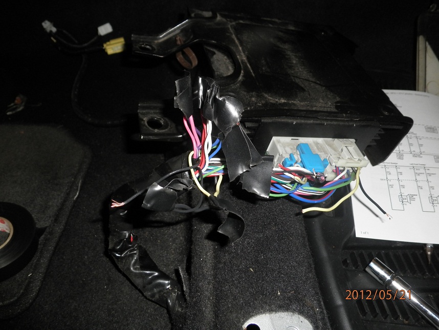

So naturally I thought if I snipped off the same colored wires from the plugs and connected them, that should bypass the integrated amplifier all together and I should get signal directly from my Pioneer deck to the speakers. To test this theory and the correct wires:
I know it's a hack job but this is only for testing, lol.
I only connected the rear speakers at first because they were the simple ones.

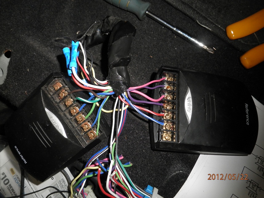

The front speakers, however, is separated into the main speakers and a set of tweeters at the front. Wiring for the front tweeters are 'BLU/WHT' (blue with white stripe) as LF-, 'RED/WHT' (red with white stripe) as LF+, 'BRN' (brown) as RF- and 'GRN/WHT' (green with white stripe) as RF+. Since I'm installing Infiniti Reference speakers all around, I have these crossovers for the front main speakers and the tweeters.
Now the tricky part to this is you have two same colored wire, one is the input from the head unit to the integrated amplifier and the other one is from the integrated amplifier to the speaker. For the rear speakers you don't have to worry about which one's which because you are snipping the wires and connecting the 2 same colored wires that's coming from the main harness. But for the fronts you have to figure out which one is the input and which one is the output. I didn't even think of that until then and was just going to figure it out by trial and error but I lucked out. If you look closely at the wires, even the same colored wires are different in gauge (thickness). It seems like the input side uses a 18 gauge wire (thinner) and the output side uses a 16 gauge (thicker) wire

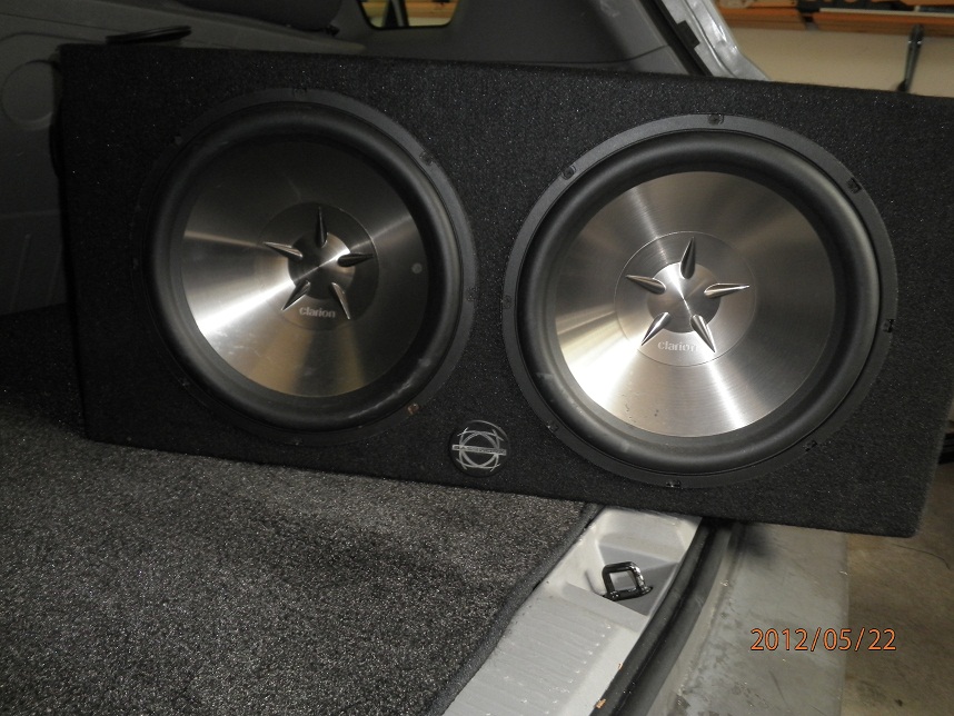

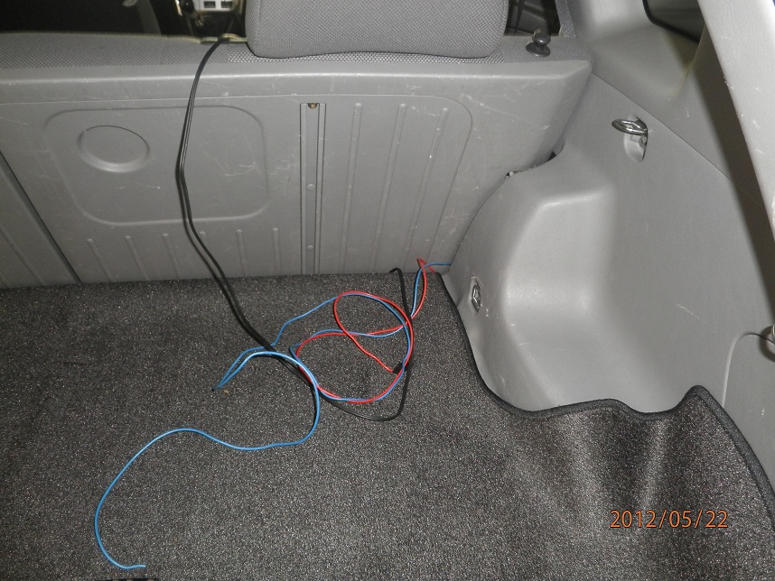

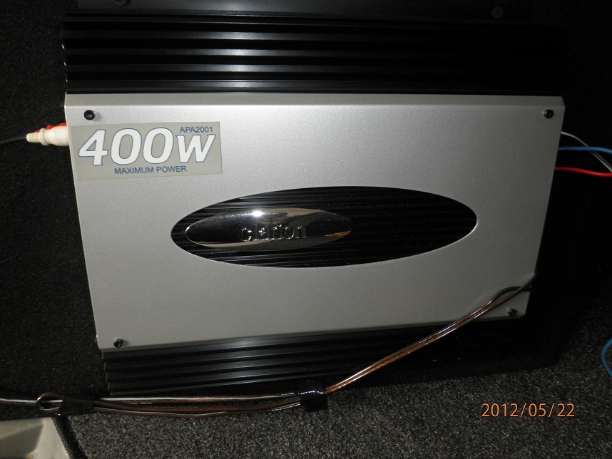

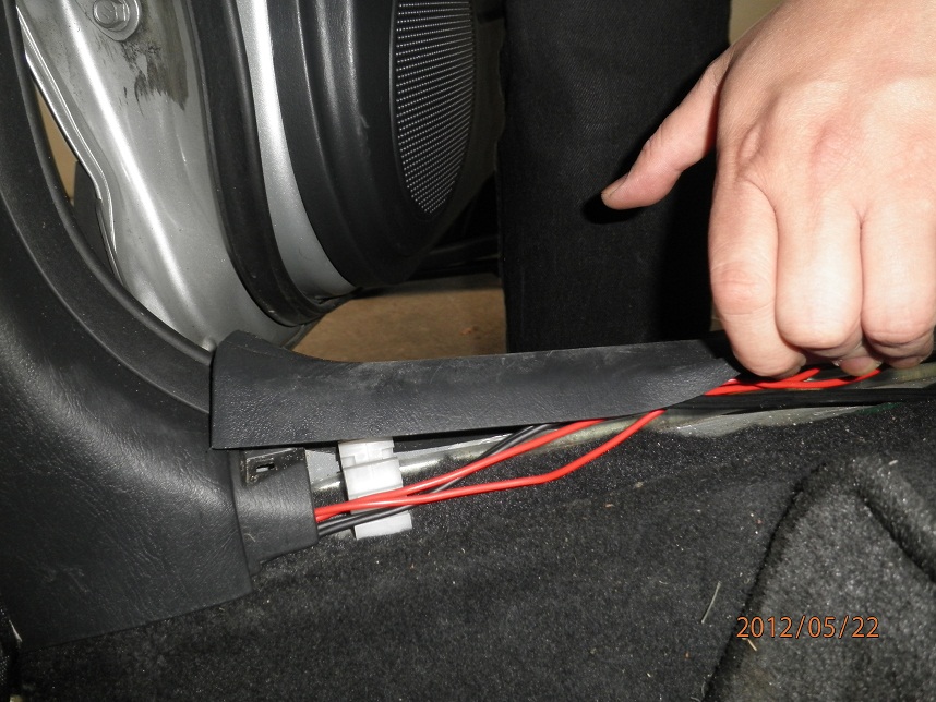

Once all the 6 cabin speakers are done, it's time to install amplifier and subwoofer into the trunk. I chose to run the wires down the passenger side, the kick plates lifts up from the inside:
and then pass the wires underneath the rear seat:

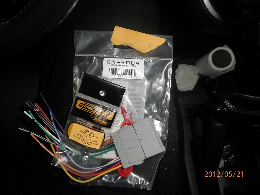

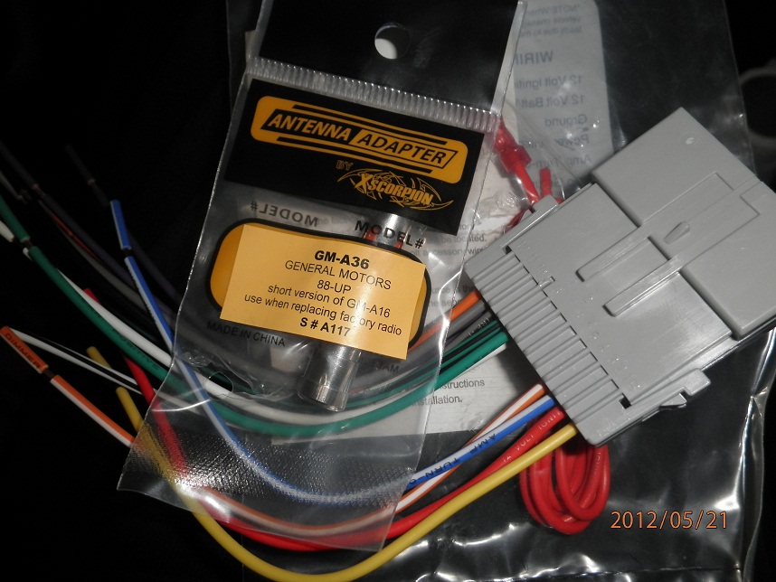

Now to hardwire the deck into the car, I choose to buy these for the install. Comes as a package on ebay with the wiring harness and the antenna adaptor for CAD$12 shipped.
