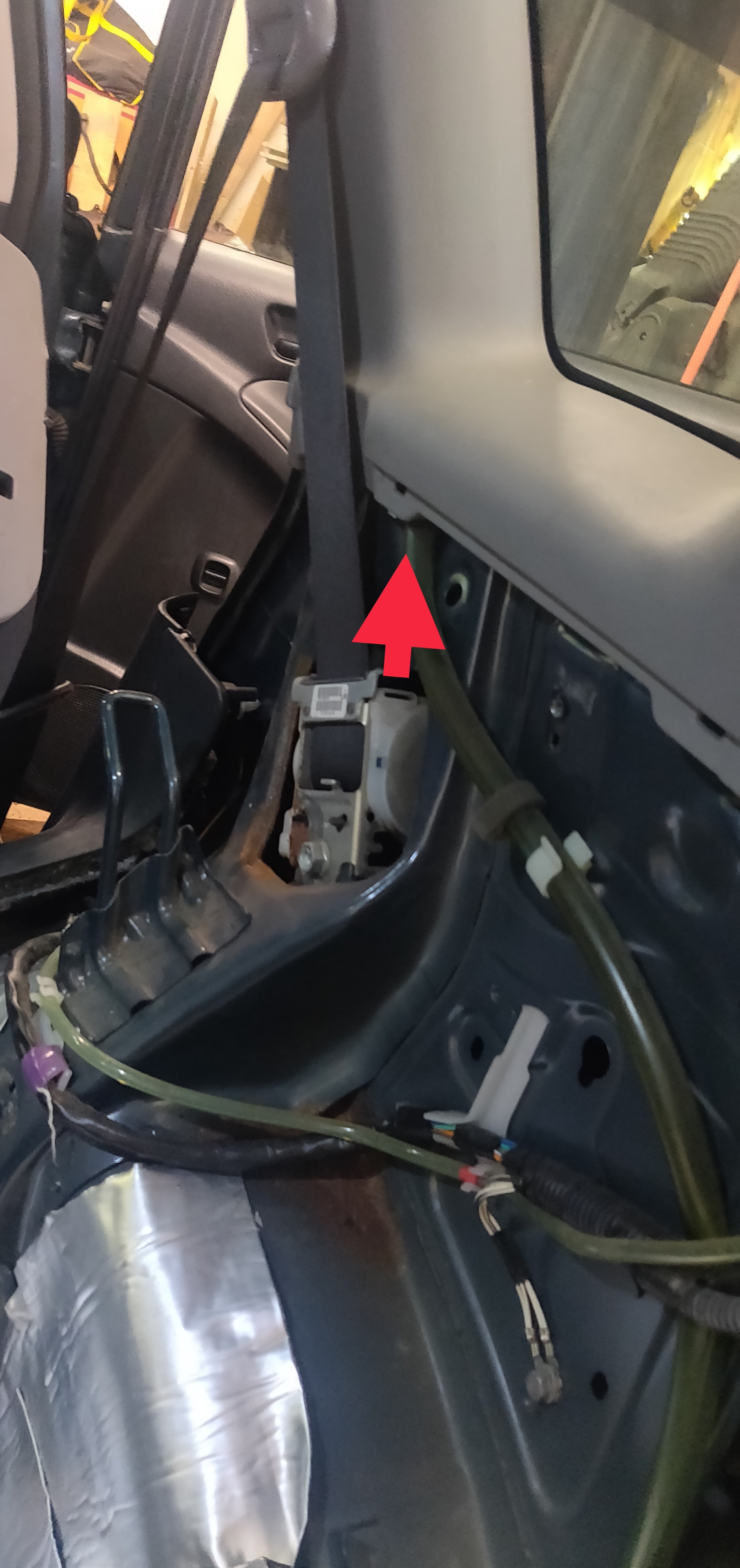

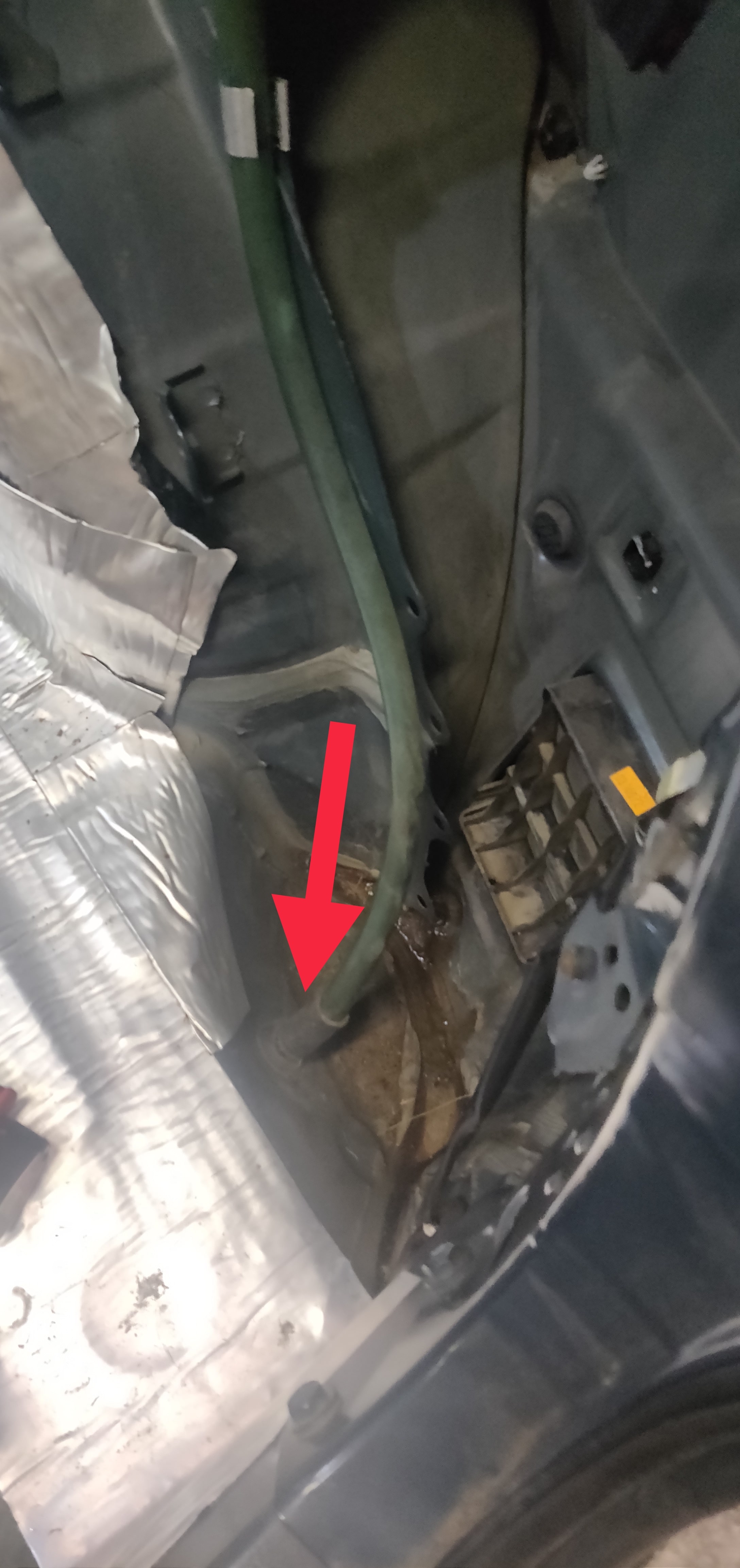

Jammin, I took these two pics showing where the rear sunroof drains exit.. Turns out it's basically at the back of the car. This is the passenger side drain... I presume the drivers side is simliar.
This shows where it exacts near the rear tail light.
Sunroof Drain Exit-min.jpg (658.55 KiB) Viewed 33799 times
This shows where it comes down the back side of the c-pillar
Sunroof Drain C Pillar-min.jpg (690.46 KiB) Viewed 33799 times

THANKS so much for taking the time to post those pictures
A+++ and appreciation.

Okay, so I have a major leak in the vibe (rear passenger floor). This ultimately filled up the entire passenger side of the car. At first I thought it was the windshield. I checked the air intake drain and book it was clogged. Cleared that up and thought it was fixed. It wasn’t. Then I checked the front sun roof drains, but they were also clear. Then I took the entire headboard off and the rear panels to check the rear sun roof drains like in this post and they were clogged, but not clogged enough to warrant the amount of water coming in. So with everything off I closed the doors and sprayed the car. The water is coming in through the roof rack until the frame of the car, down the B pillar and A pillar and filling up the rear passenger floor board. This is what happens when you experience a Vancouver Atmospheric River.
