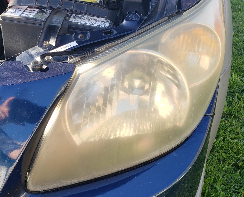

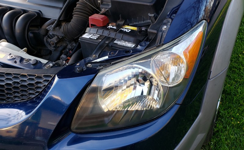

This is the 3rd time I've redone the headlights. This time I used the kit from Rain-X, though with a few tweaks... Given how tedious this has been in the past, I enlisted my DA polisher, Meguiars M105 and the Harbor Freight compound and polishing pads for assistance. It's a little difficult to use the 6" pads for this process, but that's all I had so I made do.
I started with M105 and the compound pad which knocked quite a bit of that old, yellowed sealant off. Went through the manual sanding steps and hit it with the DA again a few times in the process. It was a lot easier this time around, way less manual labor. ;)
For the step with the plastic polish, I used the polishing pad on the DA and then followed it up with a thorough application by hand.
As usual, the driver's side turned out great but the passenger side can only be improved so much. I guess that side of the car has had more direct sunlight over the last 16+ years, giving it that permanent weathered look.
Will see how long things last this time. :lol:

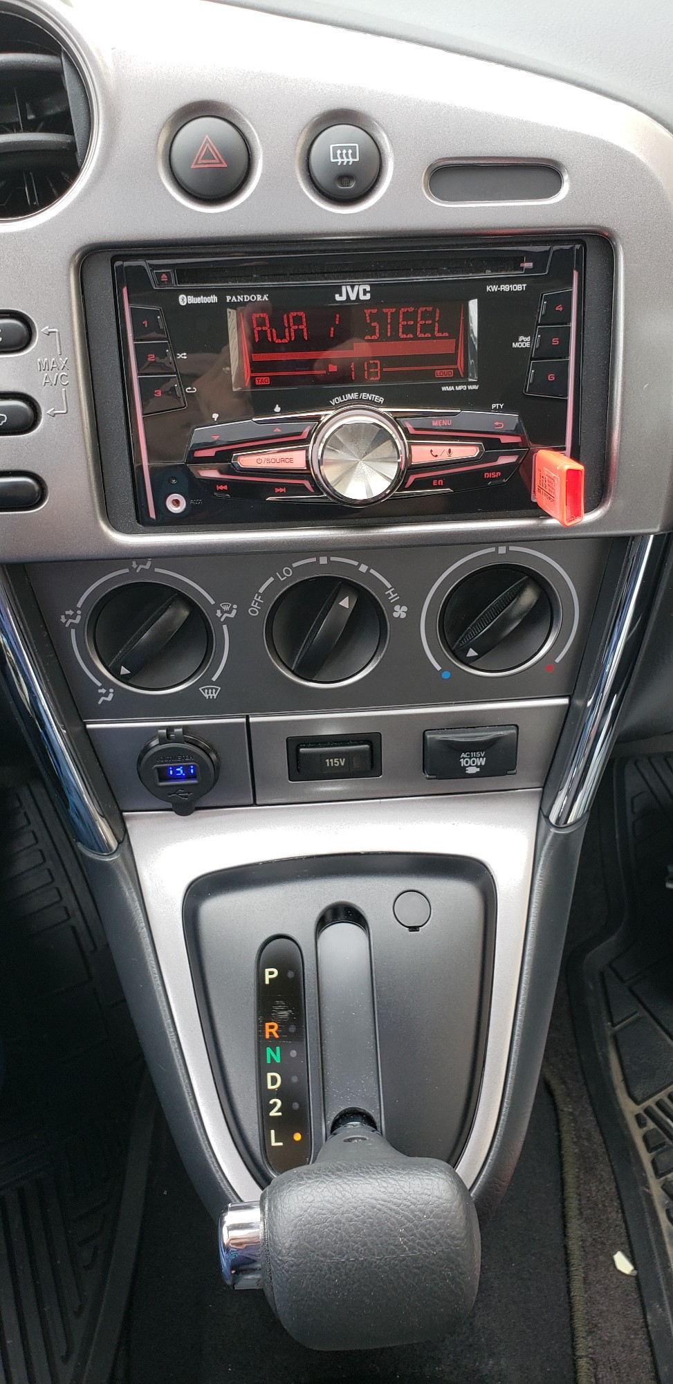

Nice! Did yours fit in the lighter opening without modification?

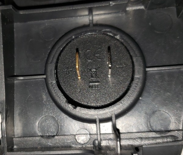

I bought this one, thought it'd be handy to have since it also has a voltmeter on it. It almost fits in the hole, but the threads on it make it too wide. Bummer, it's a pretty neat little gizmo! I'll have to find another use for it somewhere. :D
20190430_195949 - Edited.jpg (101.81 KiB) Viewed 623779 times
20190430_200519 - Edited.jpg (70.59 KiB) Viewed 623779 times
I don't want to dremel out the trim panel since I paid a pretty penny for this thing, hate to go hacking into it. If yours fits the opening as-is, I'll forego the voltmeter one and try to find one like yours.

I had the SDM and inflator recalls performed this week, so I spent some time today I reinstalling all the good trim and the JVC radio. The guy at my Chevy dealer who did the recall work didn't add a single scratch when doing the repairs, so I probably would have been OK to leave the good stuff on there!
And yep, I managed to get that charger installed. :D As I mentioned above, I wasn't too keen on modifying the trim panel, but I had no issues modifying a $15 charger. :P Since the charger had a metal body, I grabbed a file and went to town on it, shaving off enough to let it go through the existing lighter opening. I did file some plastic out ever so slightly from the panel, but not enough that would prevent me from going back to a regular lighter socket if need be. Despite all the filing on the charger, I managed to not wreck the threads so the nut was still able to thread on there nicely and tighten down.
The voltmeter seems to have a pretty quick sample rate. Unsure of accuracy at this point.
Briefly plugged my S9 into it, it does fast charge the phone.
I have the power coming from some taps that are on the radio's positive and negative from back in the day where an FM modulator was connected.
Come to find out, the connections at the taps might be a bit flaky, so if it stops working I'll be tearing it apart again and running a wire over from an add-a-circuit in the fuse box.

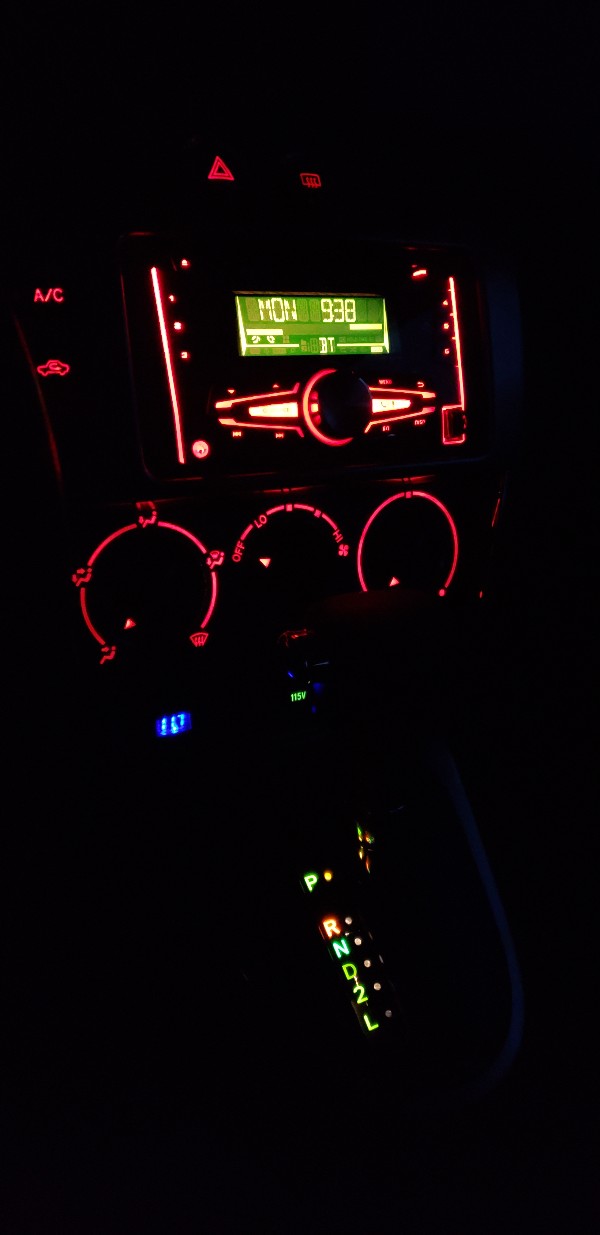

I went out to see what it looks like at night... Ouch, the LED's are a bit bright!
I have some "LightDims" film that I use around the house for various devices with obnoxious LED's that light up a dark room. I cut out a piece to cover the LED's, much better. Granted, now I probably won't be able to see the car's voltage in the daylight but what can ya do? :lol:

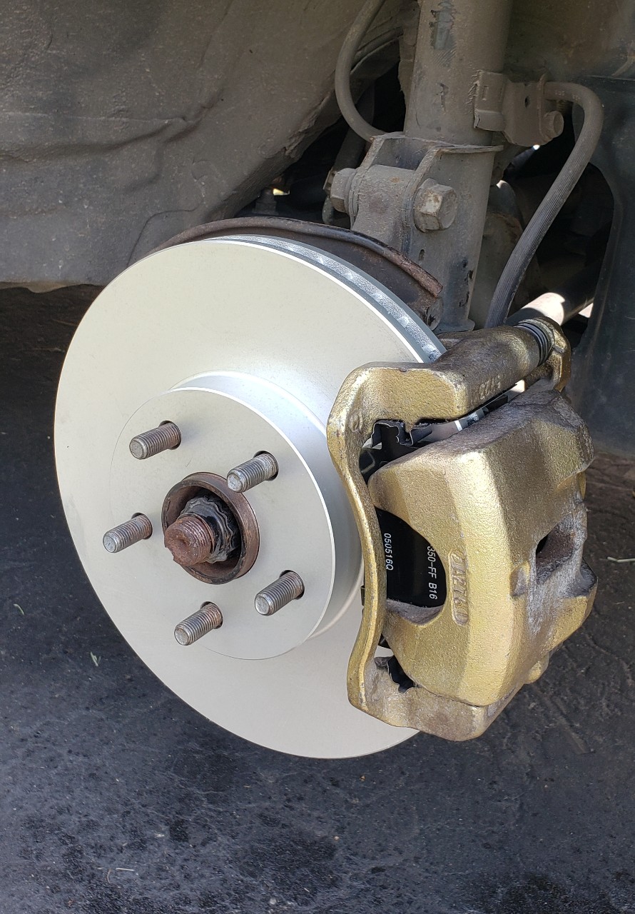

She's recently developed a case of the shimmies while braking. Given the low mileage on them, I probably could have just had the old rotors turned but new rotors are cheap. And I already had a new set of ACDelco Professional ceramic pads laying around in my Vibe parts stash. Might as well use them.
The rotors used are Raybestos Element3 coated rotors. I really like them, all three vehicles in our fleet now have these installed. Pretty good bang for the buck and they stay looking nice. Not like that matters on this steelie-equipped Vibe. :lol:
Pretty uneventful job, she's stopping schmoove again. Hopefully things stay that way.

Paid the $39 at Sam's Club and got my headlights nice and shiny and got a 5 year warranty as well. I doubt my car will last that long though.

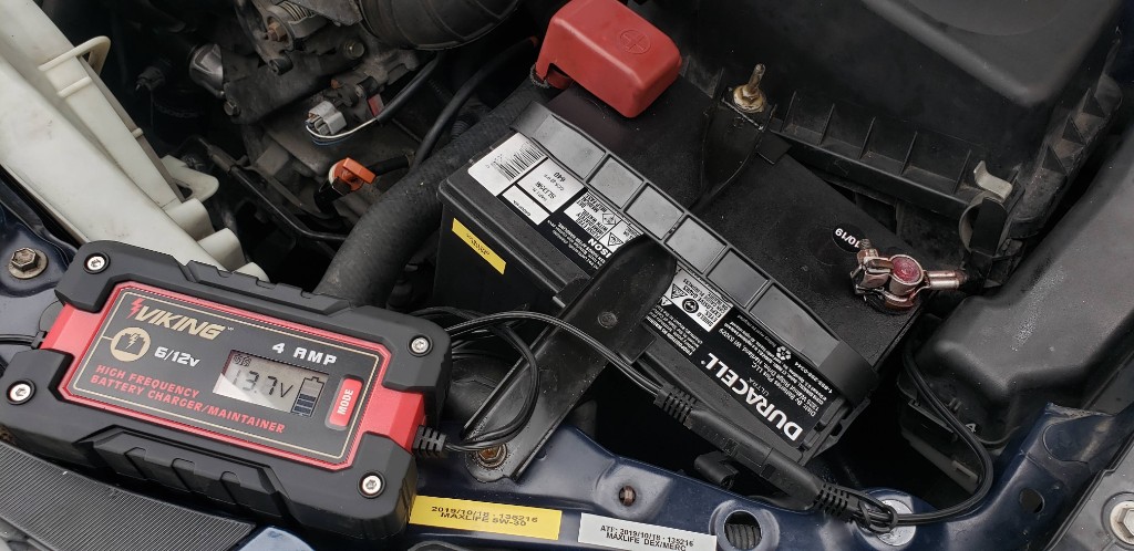

Replaced battery due to a sloooow crank concern without any troubleshooting whatsoever. Because of course I did. :roll: I figured it's had a rough life - 6 years old, most of that time sitting around and when the car is driven it doesn't travel great distances. And I didn't own a charger until recently.
Charged the new battery and installed it. Still cranked slow. On Christmas Eve, temps were in the 60s but if you listened to the starter you'd think that it was trying to turn over on a 0 degree morning. The starter finally conked out while I was trying to get voltage measurements. No sounds except for the fuel pump and a relay click. It never cranked again, even after some persuasion with a hammer.
On Christmas day, I confirmed I was getting voltage to the starter and then pulled the fan shroud and starter. Picked up a reman starter from Oreilly the next day. It cranks super fast now - who knew? It's not like the starter has been giving me warning signs for the last 5 years with the rattling it did on cold starts below 40 degrees. Or the fact that it always seemed kind of sluggish. :twisted:
While I had it all apart, I hard-wired the pigtail that came with the charger/maintainer so I can just plug it in and let it do its thing.
Also finally replaced the oil pressure sending unit, which was made easier with the fan shroud out. It's doable with a 24mm deep well and a ratchet, but there wasn't enough room to get a torque wrench in there with the shroud in place. No leaks and so far the oil pressure light hasn't done the weird flickering thing on startup.
TL;DR: Listen to what your Vibe's starter is trying to tell you before you condemn what may be a perfectly serviceable battery. :D
