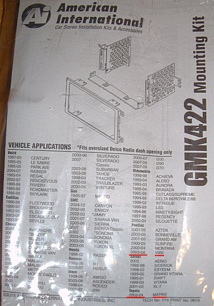

I ordered this dash install kit: http://www.ebay.com/itm/361202928558?_t ... EBIDX%3AIT
It cost another $8, but I ordered an ISO male wire harness: http://www.ebay.com/itm/221180761426?_t ... EBIDX%3AIT
You might ask "Why?!?!?!". It's because the stereo comes with an ISO to stereo adapter. I don't want to CUT IT and then if the unit is bad, have them blame me for damaging it by cutting the harness wires, and refuse to honor warranty. So it's a way to avoid potential warranty issues. I still have to splice the ISO adapter to the Vibe harness adapter but that's fine. I'll just have a mess of harness adapters stuffed in behind. :lol:

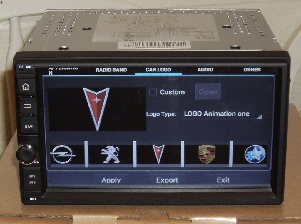

The head unit and the DIN connectors both came today, so I hooked it up to a temporary AC/DC 12V/4A power adapter so I can get it set up with apps and all before I install it. This way I don't have to idle the car for hours or risk running down the battery. Plus my WIFI doesn't reach the parking lot so I'd have to go someplace else for WIFI. My home WIFI is super fast anyway so yeah.
It has the Pontiac logo already in it for the startup screen. :mrgreen:

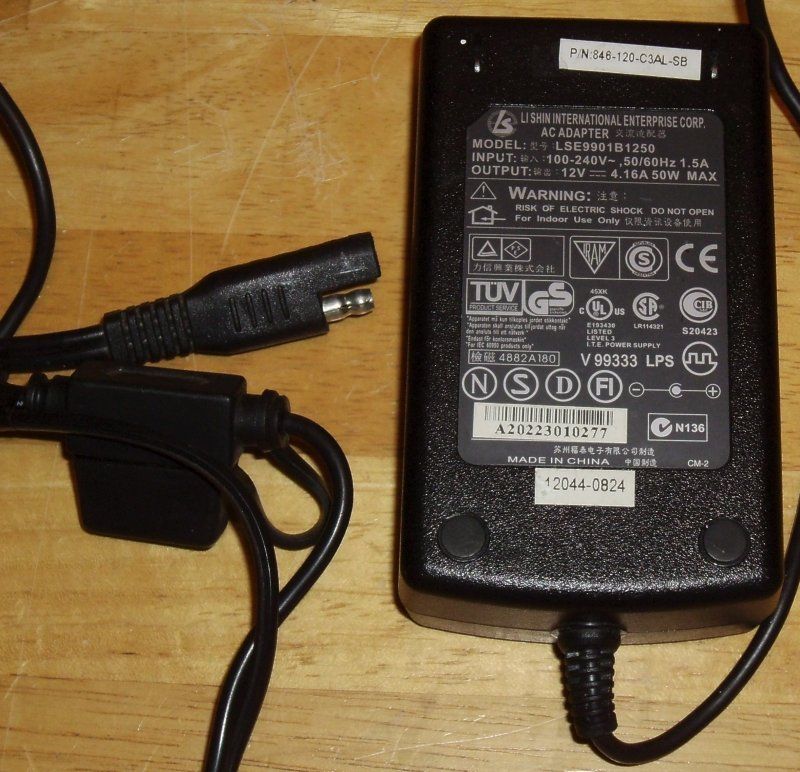

I'm glad I bothered to go pay $3 for this 12V/4A AC/DC adapter considering how much time I have spent setting it up and finding software for it. I rarely buy Android software but I did buy this one last night ($3.06). It looks good and lets you add any apps to the home screen. Plus it can be set as your default launchet, so when you hit the physical "Home" button, it takes you to it. Maybe there is something better for free but this one was cheap and looks good. https://play.google.com/store/apps/deta ... r.motorcar

DAMNIT, the kit doesn't fit the stereo by any means. :x
I already broke tabs for assembly so it's only good for a Vibe/Matrix now.
EDIT: After much work grinding and filing the install kit, I made the head unit fit through it. Yes, it looks a bit hacky but it beats having to put the unit BEHIND the kit. now it can poke through.
Neither the head unit nor the install kit came with screws to fit the head unit, to mount it to the install kit! I found one in my box of screws and it looks to be find thread metric. I'll take it in to Ace hardware and find which it is exactly.

I used one I got at a small thrift store 2 blocks away that I know sorts their power adapters by voltage (for the most part).

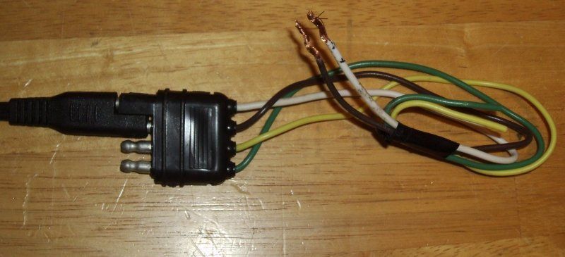

I cut off the original end and soldered on one with a fuse holder and a connector (I already had it, I pick up stuff like that when i find it very cheap) for future testing of 12V stuff.
I used a 4 wire flat trailer harness with it (which I also already had), just splicing in the bare wire ends to the power leads for the stereo.

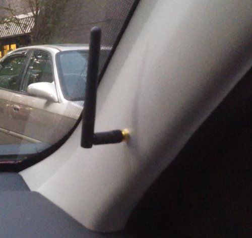

The original rg174 extension cable I bought never showed up from China. I got a refund and ordered one in the US.
When I went to install the adapter piece in the head unit today, I found it out that it DOESN'T have a"U.FL IPX" connector on the main board. :roll:
I ended up just cutting off the end of the dinky WIFI antenna and splicing+soldering in the adapter, so it works out the same. So now there is an RP-SMA connector on the back of the head unit for a WIFI antenna, just like I wanted. I ran the extension cable out from behind the unit and down below the glove box, and tested it out. It has MUCH better WIFI reception now! I can actually update my apps parked at home now.
I need to finish the install sometime this week since it's just got the cable and antenna sitting loose in the passenger seat.
So yeah.... if you get one of these head units or a similar one and you want an external WIFI antenna, it might or might not have a "U.FL IPX" socket connector on the main board for it. If not, you can solder in an RP-SMA pigtail pretty easily.
2003 Vibe Base A/T
BenWA
Posts: 360
Re: Won an auction for an Android head unit!
Post by BenWA »
Here is the antenna I put on. I have a much longer one, but it won't stay upright. It rotates and falls down over the vent just below. It looks rather silly having a zip tie holding it upright. Positioning it any other way, it would interfere with the airbag. This small one works well enough so I'll leave it on for everyday use. I will keep the bigger one stored in the car in case I ever want to swap it out. It just screws on by hand, after all. It's just a matter of 15 seconds to swap the antenna.
