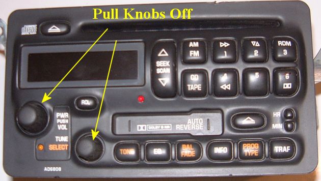

All the bulbs in the factory radios are soldered in place.If the car is still under warranty, the radio should be also. A dealer will replace the radio, and send your original one back, so if you go to get it replaced under warranty, be sure to eject the CD or you may never see it again.If you are out of warranty, there are usually some low cost units on ebay. Swapping a radio is pretty easy, it is covered in a number of other threads, but it's basically pull off the trim piece, disconnect the wires on it, then the radio is held in place with four 10mm screws, pull it out, and disconnect the wires off the back (and a wire tie from one of the brackets)If you decide you want to replace the lights inside by yourself instead of replacing the whole radio, then first you have to pull the radio out. Once you have the radio out of the car, move to a good work area where you won't lose any screws or other parts.The first step to disassembling the radio is to pull the two rotary knobs off. Just grab and pull.
Noticed pics disappeared, so editing these posts to reupload them

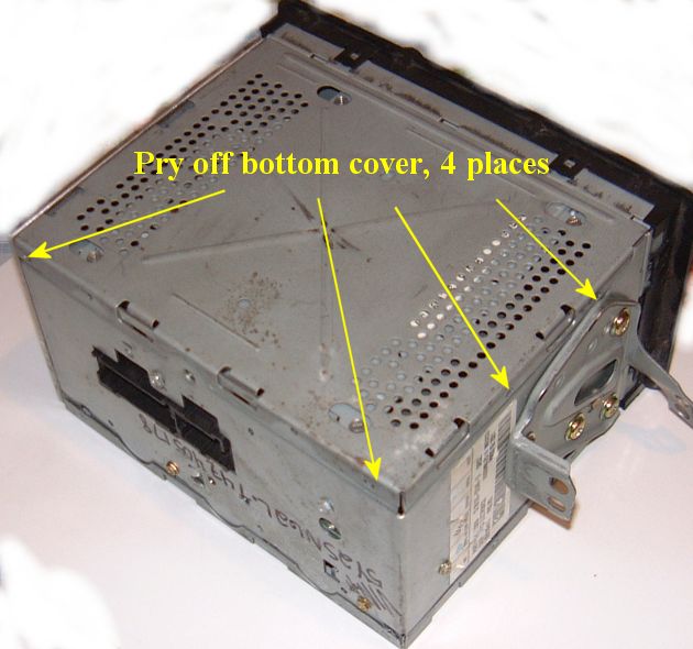

Next you have to pry off the bottom cover. There are four places where you have to budge the cover over a bump. The one on the side closest to the front can be harder because of the mounting bracket.

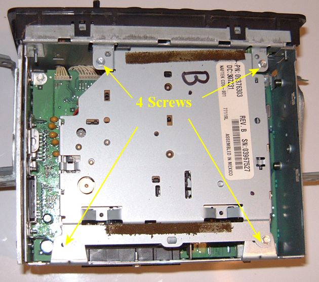

I have a CD/Cassette unit from a Matrix, you probably don't, so for you this step doesn't apply, but for me, I had to remove four screws to move the cassette deck out of the way. I've taken apart a Vibe cd unit (no tape deck, and the rest applies

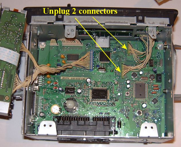

There are two wire bundles that connect the face plate to the motherboard. Remove these two by gently pulling up the wires to remove the connectors from the motherboard.The connectors are different sizes, so you can't get them crossed when you put it back together. You can see in the picture that there are two holes in the chassis front, one wire bundle comes through each hole. When you put it back together, it will be obvious which goes through which(since mine is a CD/tape, there are other wires in there, but for the Vibe's 1CD unit, there are just the two marked wire bundles)

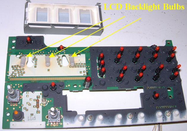

This shows the front of the circuit board with the cover removed. You can see all the lights for each of the buttons, but the LCD backlights are still hidden behind the LCD. (On mine a couple of the little white bulbs along the bottom row are burned out, but I'm not sure what bulb to put in there.)
Posts: 10262
Re: Radio lights going out (joatmon)
To get to the LCD backlight bulbs, you have to remove the LCD. In the previous picture you can see a metal housing around the LCD, it has six tabs that fit through the circuit board and are bent to lock them in place. In order to remove the LCD to access the backlight bulbs, you have to straighten the six tabs as best as possible. They have to be straight enough to slide through the small slots int he circuit board.Once you have the tabs bent straight, you have to pry the LCD and metal cover off, pulling these six metal tabs through the circuit board, so the better you can straighten them, the easier it will be. I used a pair of needle nose pliers.This pic shows the back of the circuit board small with a red box on it, and below that is a larger view of the area in the red box, with the six tabs indicated

Thank you for the step by step instructions. Your explanations and posted pictures made tearing apart the radio a lot of fun. It was really not hard to do. My biggest problem was using the soldering iron and electrical solder. It did not look real pretty but it worked. Getting the old bulbs out took a little time. The "74" bulbs work extremely well. I replaced all three bulbs. Thanks again for your help. Without your step by step instructions I don't think I would have tackled a job like this. It really was quite easy.
mdpinmich
Joined: Sat Dec 31, 2011 3:32 am
Post by mdpinmich »
Used the 12v 60mA bulbs from Radio Shack. Looks great. I cut the old bulbs off right when the wire leave the glass. The old wire is much stronger than the wires on the new bulbs. Made is real easy to locate the new bulbs in the same location as the old.I did create a small jig to hold the bulbs while soldering. A piece of cardboard with 2 parallel toothpicks(used 1 toothpick broken in 2). The 2 glued toothpicks were gapped so that they created a craddle for the bulb so that I could keep the bulb steady and the leads level. I put the bulb between the toothpicks, set the craddle and bulb on the circuit board, put it where the leads were touching the old wires, and soldered without a problem.Thanks for providing the info. Made this radio fix very easy.
