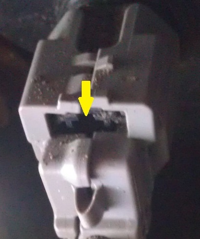

It took me awhile to get to looking at this, but I finally did. I found the connectors. It looks like this:
What I can't figure out is how to open it without damaging it. I have a Haynes manual which is useless in this area (they just indicate that the sensor is an integrated part of the assy and leave it at that, never mentioning it much further).
So how does one open the connector? If figured out how to get the grey casing off, but not the rest of it.
Thanks.

The Matrix service manual says to insert a flat screwdriver into the hole to disconnect the connector. The actual sensor itself is pressed into the hub and is not designed to be removed, but at least with the plug off you can try cleaning the outer contacts.
Image  Image

anyone try this? I tried last night with not much luck. Just insert screwdriver and pull I assume?

I haven't. Unfortunately the service manual just says "insert screwdriver" with no further explanation...
Image  Image

This was my method:
There is a tab on the top and bottom of the grey outer case, marked in black is the upper.
Once that outer case is off, you will need to unplug the connector. I kept tapping the black connector with a screwdriver to loosen the dust built up inside. Then pressed the release tab on top and pried gently with a screw driver where the connector meets the hub sensor. Best to work the top and bottom with a screwdriver, this connector will not come off as easy as it goes on.
Once off, used some toilet bowl cleaner on q-tips to the pins of the connector, then sprayed with electrical cleaner. Used some dielectric grease generously on the plug and buttoned everything back up. I did have the battery disconnected while doing this. I don't know if that plays into it. I did turn traction control off/on multiple times without issues during the test drive (beating).
Wife is happy, mission accomplished.

mitgsx wrote:This was my method:
In the modified pic you x-ed out the original annotation for release point on the connector, but in your description above you refer to "pressed the release tab on top". What part of the connector, after the outer grey jacket is off, is the release tab?

You can put a screw driver and press down vertically, like the original annotation. Like I said, for me, I had to take off the grey case so I could work with the black connector within. I to end up tapping the black connector to loosen it before removal. They were gentle taps.
Yes, the black connector release tab is on top. It can be accessed through the grey outer case per original.
It was easier to see what I was working with having the outer case removed.

mitgsx wrote:You can put a screw driver and press down vertically, like the original annotation. Like I said, for me, I had to take off the grey case so I could work with the black connector within. I to end up tapping the black connector to loosen it before removal. They were gentle taps.
Yes, the black connector release tap is on top. It can be accessed through the grey outer case per original.
Great. Thanks for clarifying. I think the original image assumed the outer casing would be removed, but it's good to be explicit.

I definitively tracked down the cause of the issue on my Vibe today. It's definitely the passenger rear wheel speed sensor. I removed the wire harness plug from the sensor and found that one of the two tiny pins inside the hub side had broken off and was stuck inside the plug. There was green corrosion and damage to the plug from arcing between the two ends of the broken pin. It's really a very poorly designed part for where it is located. The pins are no bigger than those found on computer parts (less than a millimeter in diameter) and the plug is located right where rocks thrown up by the wheels can knock against it and break the pins inside easily.
Here's the hub side with the base of the broken off pin visible on the left surrounded by green corrosion from arcing.
Here's the plug side with the broken pin visible in the right hole, which is cracked and has green corrosion from arcing.
Here's a fresh picture of the assembled plug. To disconnect, stick a pocket screwdriver in between the grey outer covering and the black plug near the top about 1/2" and pull up on the screwdriver gently to disengage the lock while pulling back to unplug it. If you pry too hard you'll just open the grey cover which unwraps from around the plug and then lets you disengage the lock on top with your finger.
I have no idea how to get the broken pin out of the plug, nor how to replace the pin inside the end of the sensor. Anyone have any ideas? Otherwise it's going to require a new hub and wiring harness, just like most people report their mechanics have had to do to fix it. $200 in parts and several hours of labor.
Image  Image
