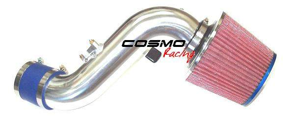

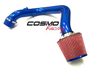

Intakes: - Base & AWD
Cosmo Racing Cold Air Intake (CAI) - http://www.cosmoracing.com/pro...d=409 - $120.50 + shipping
Cosmo Racing Short Ram Intake (SRI) - http://www.cosmoracing.com/pro...d=792 - $95.50 + shipping
