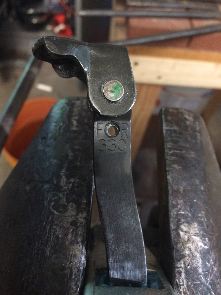

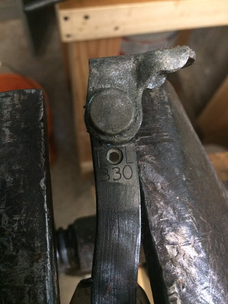

Note. I have seen somewhere that these door checks are different from right to left. That does not appear to be the case. There is a stamp on the strap that says "F" "space" "R" on one side and when you flip it, it says "F" "space" "L". These are the same part for left and right. You just need to flip them to the correct side for each door.
- IMG_0275.jpg (233.04 KiB) Viewed 7366 times
- IMG_0276.jpg (270.83 KiB) Viewed 7366 times
